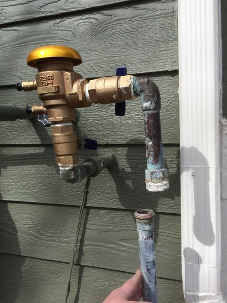

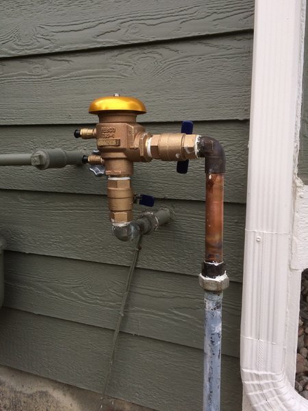

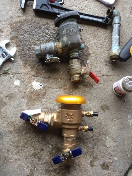

    thanks for the encouragement/push to do the repair myself....

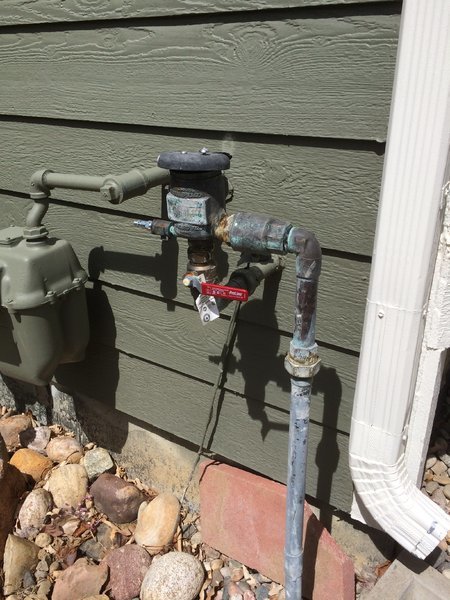

    took the assembly off at the unions and replaced the backflow as it's definitely seen better days and been an eye-sore for a while...
    she almost was a straight replacement, however, the new assembly was almost 2" taller which created a gap that could not be stretched without some extra effort
    so i picked up a new torch, some 1" copper and had a successful first attempt at sweating copper :cool:
    system is back up and running :woot:

    turns out the crack was right at the ball valve...so when i had closed the system for the winter, i must never have opened that valve back up to let that water drain with i drained the main line...water left inside that ball valve led to that crack it's definitely looking like...lesson learned and more knowledge gained

    Huh, I didn't even know you could do that yourself, I thought it had to be a licensed plumber. Probably varies with municipality. I glanced at Fort Collins and I don't see anything about who has to install it, though they do warn that not all bfps sold locally (ie, Lowe's, Home Depot) are acceptable to the utility. Also, know that most municipalities, at least here on the front range, do require inspection and certification every one to three years so make sure you look into that. Otherwise, looks good! :thumbsup:

    Nice work mister!
    Since you've demonstrated such a degree of competence, I believe you're ready for the next level:D
    In the fall, when it's time to blow down the sprinklers, take that whole assembly off like we discussed before and adapt an air fitting to a union and use that to blow down the lines.
    If you do that, your new backflow preventer should last another one of @Gramps lifetimes. :thumbsup:

    compared to the broken backflow that was on there previously....an inspector should be happy to see that repair was made, even if it was by my hands
