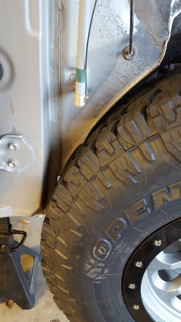

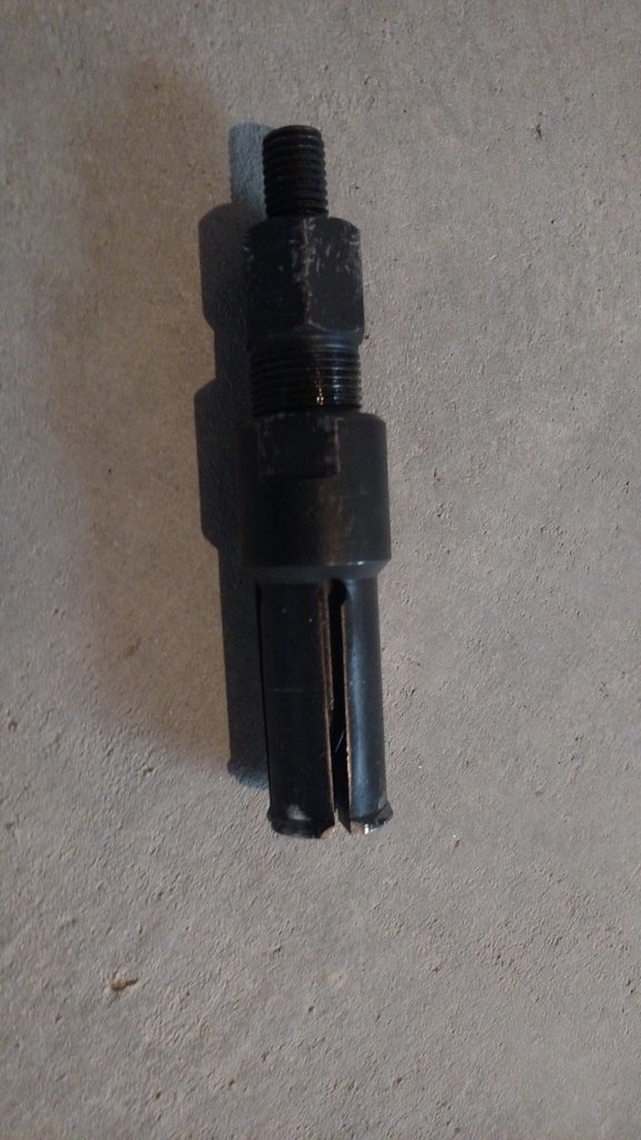

    Keep screwing the slide hammer into the tool while it's behind the bearing. What your wanting to do is use the tool to squeeze the 2 jaws out.
    There should be a small rod that goes in the end of slide hammer to help you twist

    Yeah. I’ve even tapped it around with a hammer. Still no go.

    Look like you broke the inner lip?
    Maybe @CharlieCafe or @aero3685 have a better idea?

    Time to break out the dremel

    Also use a dermal and grind away that rust before ya install the new seal. That way you don't rip the new seal

    Almost looks like it may need to be cut out now, although you should still have enough on the back of that bearing shell to hook onto. It took quite a bit of force to get @aero3685 's to move, but we also used a slightly different blind hole adapter that has more surface area.

    Thanks guys
    Dremel to the rescue! And while I was at it I pulled my sway bar. We’ll see how that feels
