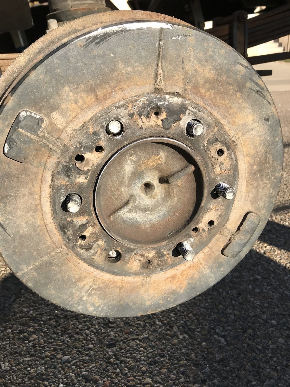

    Well this sucks...one of the hub bolts snapped and and rear left wheel fell off. Anyone around that can help? In a Longmont neighborhood right now so not blocking traffic too bad.68B6EBF0-E369-49A1-83B8-60BADA48DF1F.jpg

    Did the nuts work their way off and how do the remaining threads look? I'm not close enough to physically help unfortunately.

    The remaining threads look ok but a few of the lugs are loose in the hub

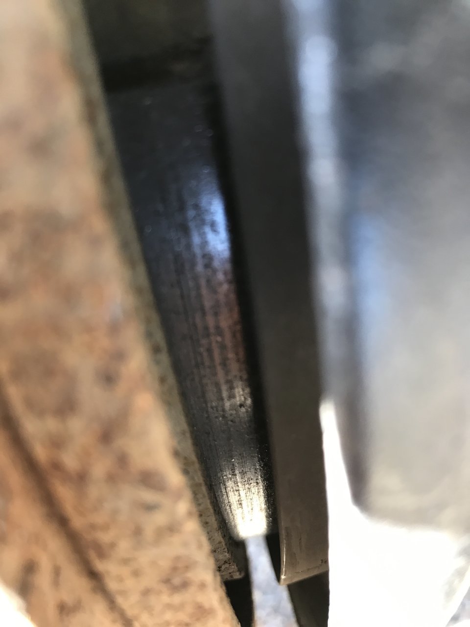

    Does this look like the parking brake seized up? Pads look like bare metal

    Can you push the drum all the way on? Hard to see, but if there's no pad left..
    See if you can thread the wobbly lugs back on and see if it'll seat them.
    If you need leverage, put the rim back on so you can pull the wheel out a little while tightening.

    I think I’m just going to call a tow truck and take it somewhere to be fixed. This is beyond my skills. Tried pulling the cover off but he drum brakes want to come with it, and yes I checked that the e-brake was disengaged.

    You could try backing off the star wheel from the little hole in the back side of the hub. Use a flat head screw driver. Then you'll have to undo the brake lines and pull the axle to get to work on those studs
