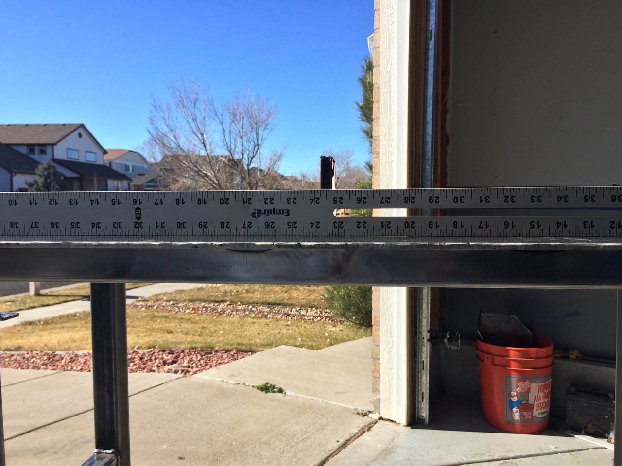

    One of the mistakes I did with my table. Since the table top frame was notched at 45* angles and bent together. I didn’t clamp down the ends to make sure it was flat before welding. Every thing was square but that little sag will effect the table top. Now I’m going to run a few beads to fill it in and grind smooth. This will make sure the table top is flat.

    Why not flip table on to flat floor, heat area and slowly smack it flat?

    Because adding more heat will distort the table even more with a rose bud or torch. Plus it’s easier to add a shim to the top and check for flat then to heat, smack and hope the bend will hold after it cools.

    Shit how thick is that metal then?

    It’s only 1/8”.

    Oh yea if it’s that thin your route is easier :D

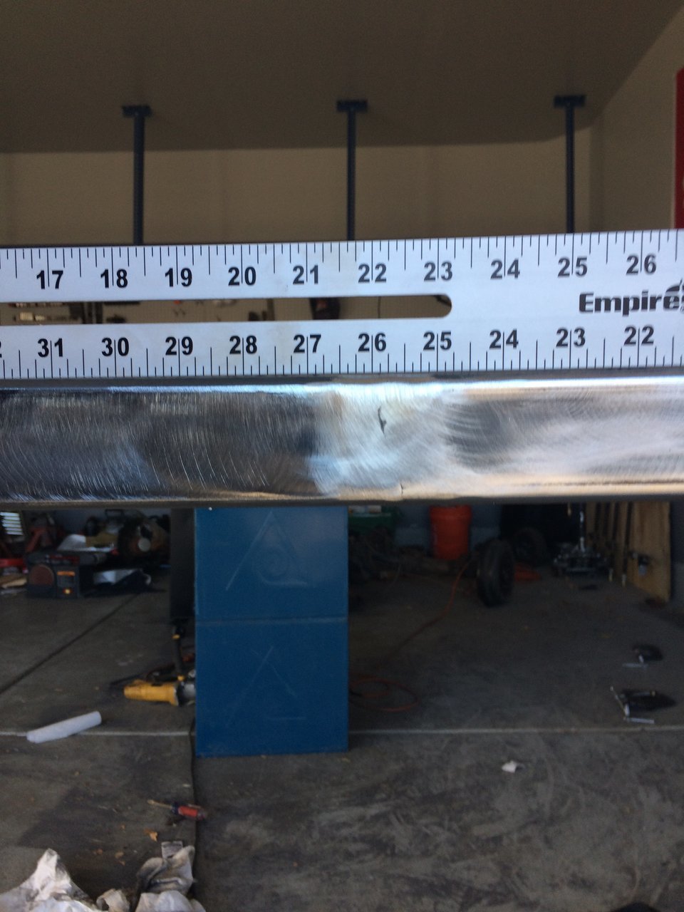

    Not to bad now. Luckily this is the back of the table.

    I’m an OCD asshole when it comes to stuff like this, and I could live with that. Nice job dude!
