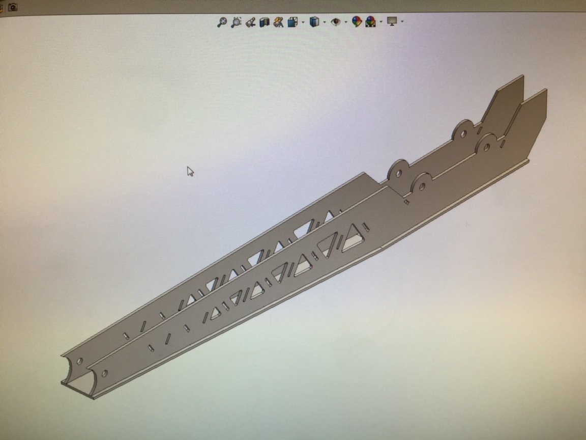

    Take out 50% of your triangle gussets and the windows associated with them, or install a big drain hole on the bottom plate. And how are you cutting these? @jubei know how much to over size for the ( I ASSume) plasma table so it the tabs and slots go together without much hassle? Just tossing some inside out there as I draw/design parts and can see lots of problem areas that can be corrected before it gets built.

    I have an idea for the tabs. Not a big deal. I can always grind to fit whatever I need. It wont be much. But as for a drain holes. I'll have two drain holes in the canoe side of the link. I've also though about if I ever get stuff inside of the link. I'll drill it,clear it and weld the hole closed. Not a big deal. I'm not going to remove any gussets. I'm keeping them all. I don't want to twist the link if I bind it. That's why I have gussets though out the whole link.
