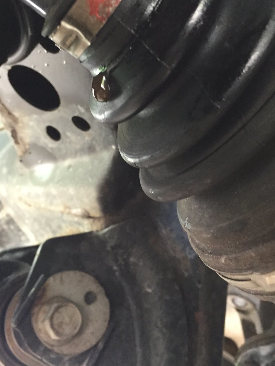

    Ok guys
    Under the truck doing oil change greasing DS and stuff discovered this BF11478C-BE75-4102-8A19-4934489F3F05.jpg am I correct thinking it just needs a new boot??
    If so can someone help me with replacement? I’m a little mechanically inclined but some help and guidance would be much appreciated :D

    Is it grease? hard to tell from the pic

    Yep
    My boot looks cracked

    Clean it. Wrap it with duck tape to hold you by until you can replace it. It's not fully torn. Just a hole.

    Yeah, sounds like you would need a new one. If you poke at it and more grease comes out or it looks like there are grease droplets sprayed inside your wheel well you can be certain

    if you let it spew all the grease the CV won't last too long

    Ok will do thanks Ray
    Clean with brake cleaner before wrap?
    Ya I wiped it off and more just oozes out
    there is some spew in there :D
    Got it :thumbsup:

    Try and have the hole on top to see if that helps keep the grease in until you wrap it.

    It seems to be cracked on that first seam halfway around
    I’ll see what I can do
