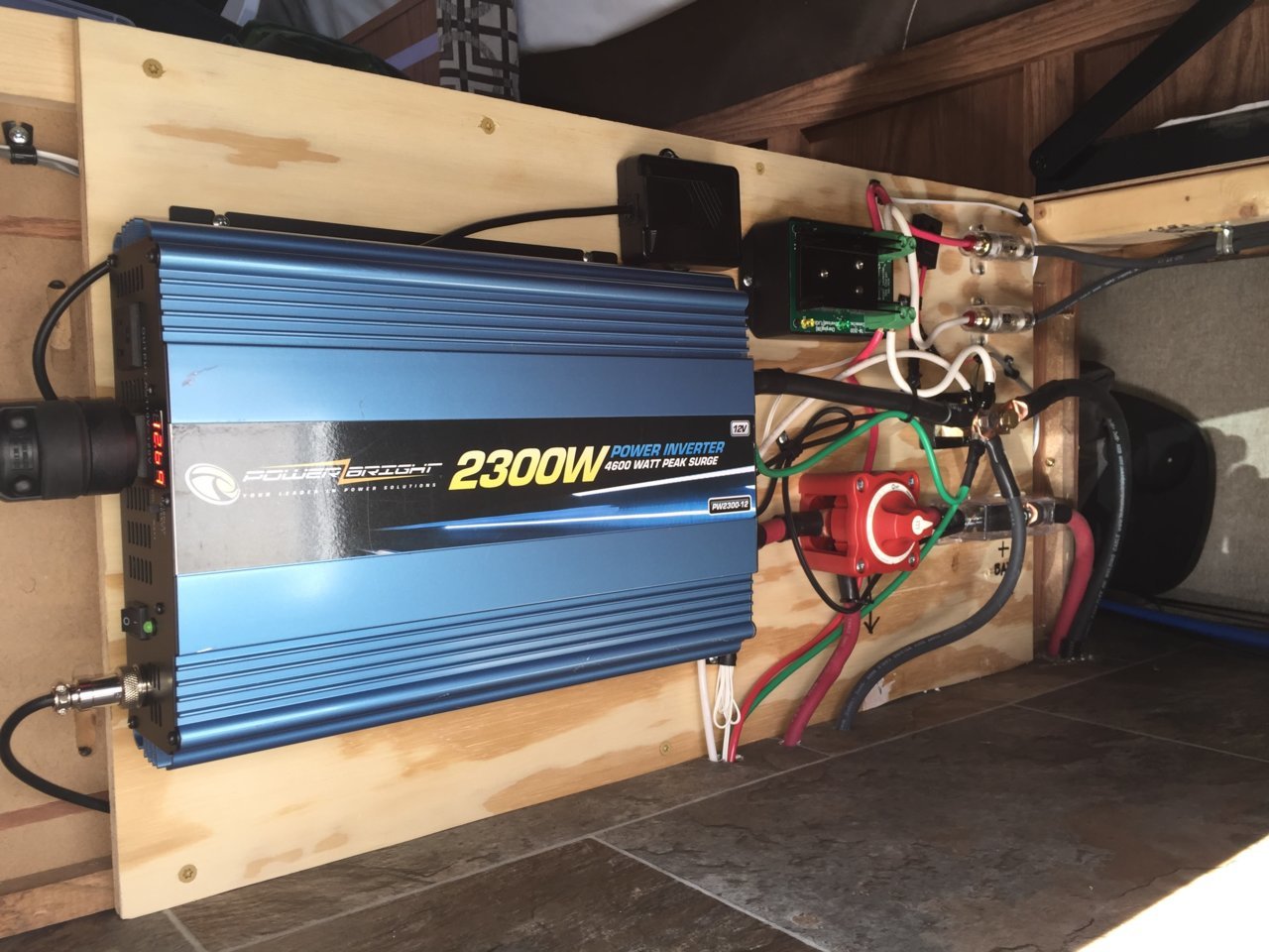

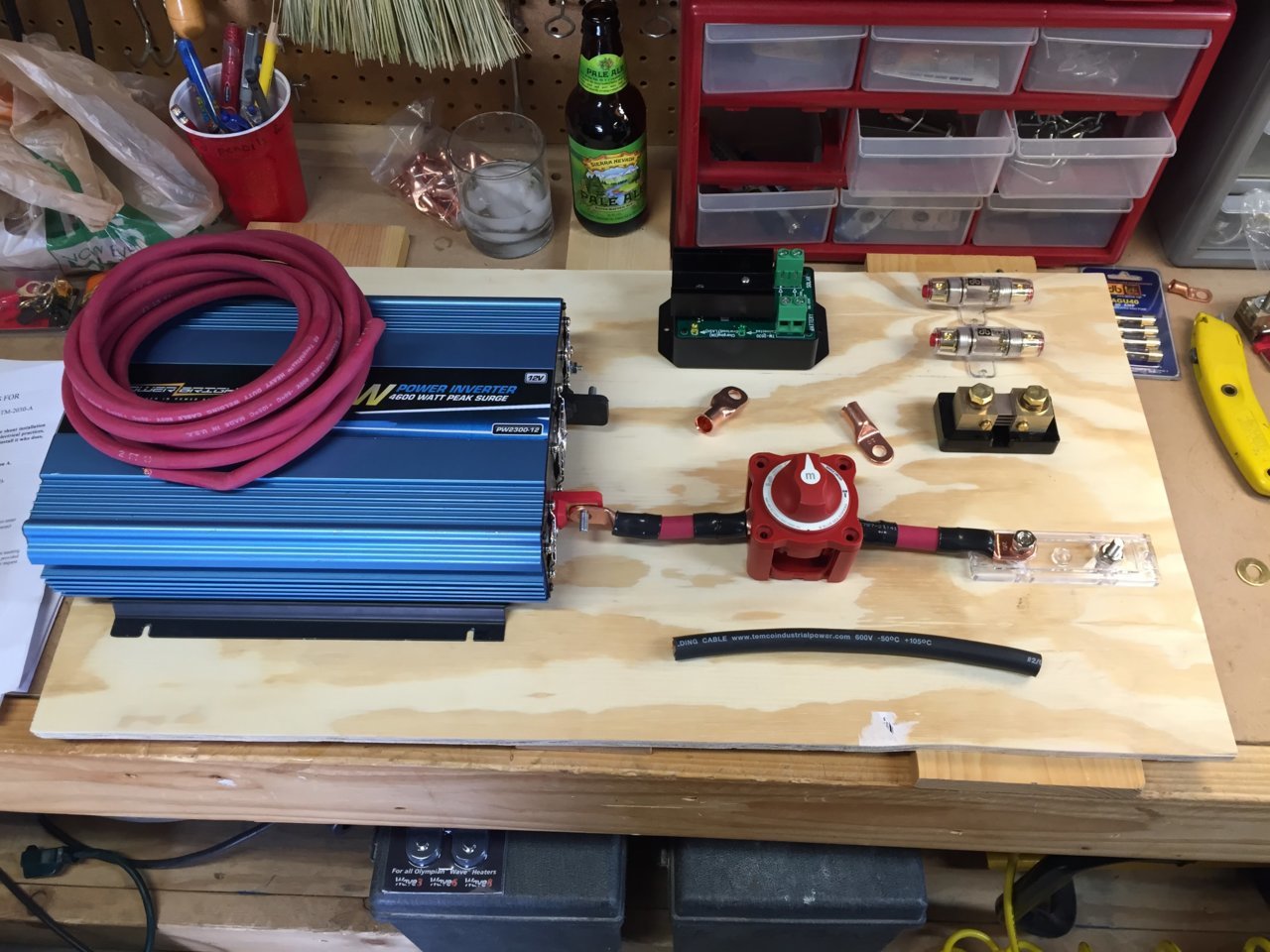

    I ended up rigging all of this stuff up, and running new bigger wire under the camper to the batteries:

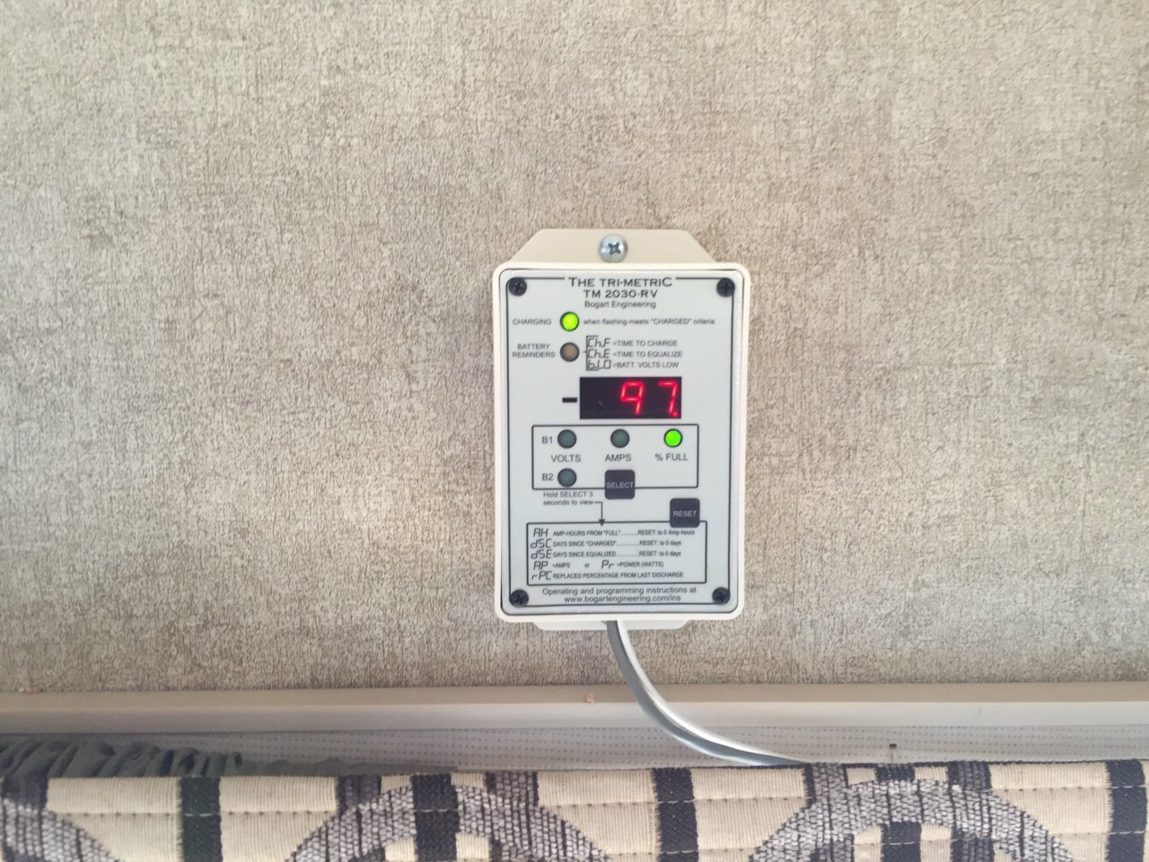

    The best controller and "brain" combination is this thing. It's way better than most of the offerings out there and will keep you batteries in tip top shape, makes them last longer.
    http://www.bogartengineering.com/products/trimetrics.html
    the 2030-RV is the bomb... but I'm probably making your life too complicated...

    Forgot to say... We use the inverter a lot. It's hard wired into my main panel so, basically when I'm not on shore power, the inverter makes all of the standard AC plugins in the camper work.
