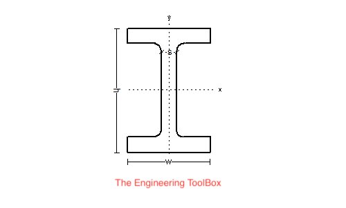

    Have you called DenCol, Altitude, Ryerson, maybe Rio Grande?
    Have you ever specified a steel beam? It's confusing. You'd think S3x7.5 would mean a 3" wide by 7.5" tall but it's really a 3" deep by 7.5 lb/ft. So you get a beam that will have h = 3", W=2.509" and S=0.349".

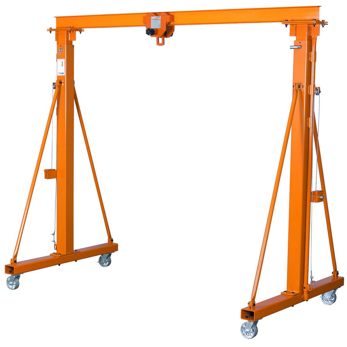

    Not that I would necessarily trust it, but Harbor Freight sells a portable gantry with a trolley.

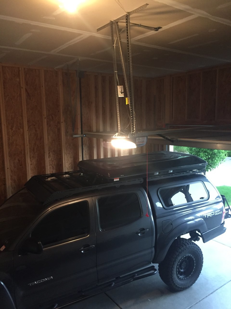

    Ill take a look, not more than 600-800 lbs i need a new hoist for my RTT. Father is stealing my other one. Pondering ideas what would work best. I got alot of verical storage. house i bought has 13’ ceilings. My other thought is storing my camper shell when i want to remove it for somthing. Would take the other hoist ,but ceiling is to high to operate it!
    I was looking at trolley so i can move the tent front or back of the garage. But i am kind of just pondering ideas. This might be more trouble than its worth/ over kill.
    I know my idea all depend on how my roof is supported and if the joist can handle it!
