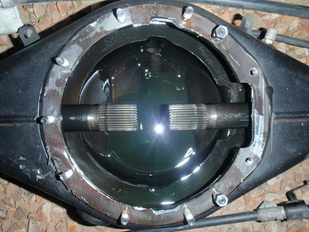

    You could technically run a regular 8”, but you’d have to make a custom block off plate / gasket combo to seal up where the elocker motor goes.
    Also if they did go down this route they should probably get a 96+ 4runner differential due to drive shaft flange bolt patterns. (I’m pretty sure that’s when they changed over).
    Here’s the elocker axle opening, look to the bulge out on the right.
    Easiest diff to find will be a 4.10 or 4.30 elocker from a runner or Tacoma (first gen). I Personally would find a 4.10 Tacoma elocker and then later swap out a 4.10 4cyl 2nd gen Tacoma front diff #regear

    I've never personally modified an axle housing for an e-locker, so it was my understanding that a regular third would still fit and seal around the outside, obviously with only part of the sealing surface at the notch. IOW, the bolt pattern is the same but you have to put the notch in for the locker motor. But it sounds like the shape of the carrier itself may not match so it would leak.
    My suggestion is only based on the premise that being stuck on the trail unable to move having the option of using a plain old 79-95 4 cylinder 4.10 third member since those are usually piled up by the dozens in junkyards and would be super cheap (as in I gave away one when I went to V6 diffs with Air Lockers). I agree if you're narrowing down on something more specific that a locked lower ratio one would be a better way to spend money.

    Yeah, looking closer, looks like it would probably seal. Would probably work on the road missing two studs.
    Also just thought 4th gen/fj cruiser 07-09(auto) 8” non locker would be 3.73 also

    You guys are right. The housings are different. So we ended up getting an open diff 3rd and it was slightly different so we are still on the hunt for an e locker 3rd member.

    You should be able to use:
    96-02 4runner elocker (4.10/4.30/4.56)
    95.5-15 taco elockers (3.73/4.10/4.30/4.56)
    07-09 fj elockers (3.73/3.93)
    The 4.56 version is the rarest oem one, I’ve only seen a couple. They came in early auto 2.7 first gen Tacoma’s when optioned with the elocker, and early 2.7 manual 3rd gen 4runners optioned with an elocker.
