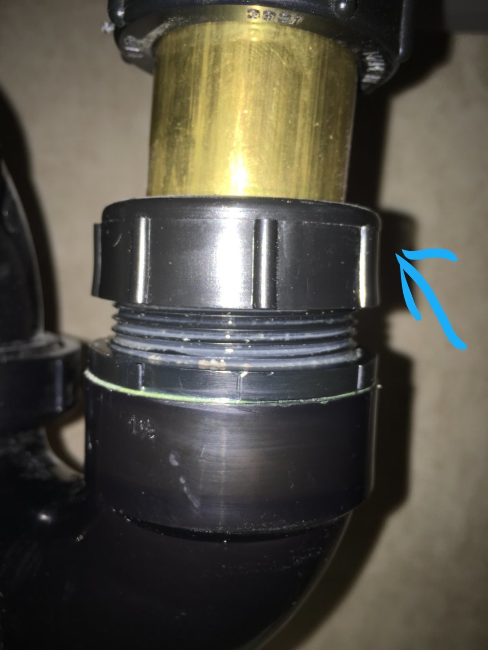

    Plumbing people @teamhypoxia the sink drain is leaking at the bottom collar. Unscrewed it and looks like it has a plastic gasket? Can tell the connection isn't straight at all.

    Going to want to get it straight if you can... the trap assembly you may be able to loosen and slide out to fix it. The plastic rings you can snag at any hardware store if that one is jacked up, but it probably will seal if you get the connection lined up.
    Or just flex seal it

    Forgot the picture.

    RV plumbing is not always the same as house plumbing. Its usually chintzy as hell.
    A pic might help. Edit, i see it now.
    Or flex seal it and carry on.

    Loosen the other end of the p trap, straighten it out and tighten it back up. Might be all it needs.

    Is the sink tilted or the trap?
    Is there an adjustable nut on the second connection down from that? If so, loosen it to straighten the trap out.

    A
    after looking at the picture again I might be able to loosen that other connection and rotate the pipe into better alignment.
