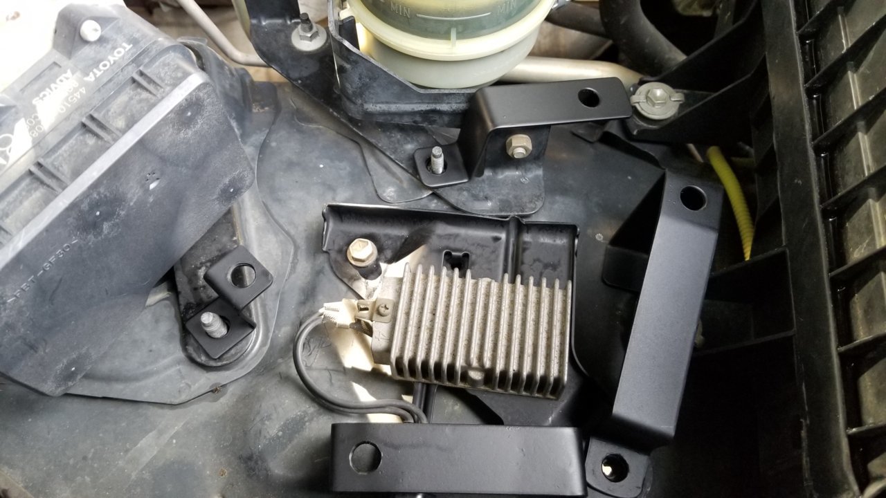

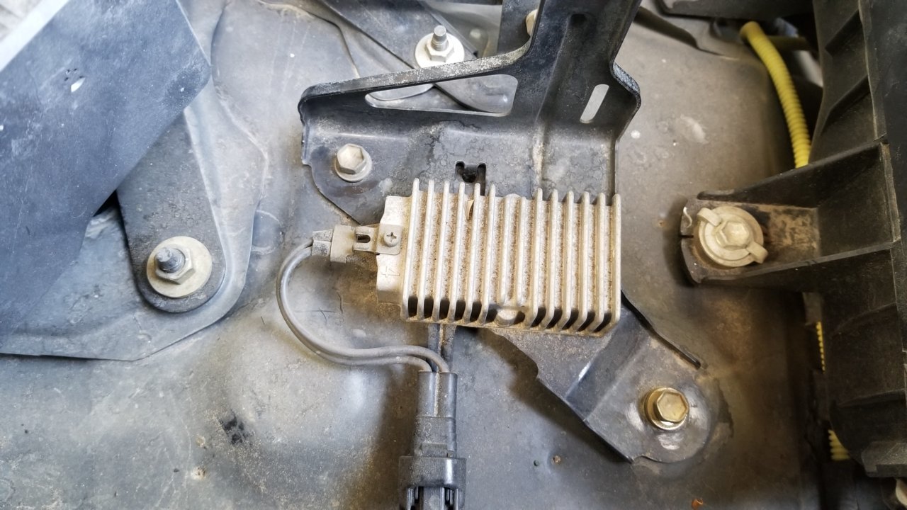

    What is this thing? Just a resistor? and can i relocate it?
    Does it need to sit flat or can I mount it vertical?
    Looking for a spot to mount the air compressor and this would be great if that doesn't need to be right there in that exact spot.

    Unplug it and see if it runs. If it does not it is your 2 speed fuel pump resistor, if it does it is for the DRLs

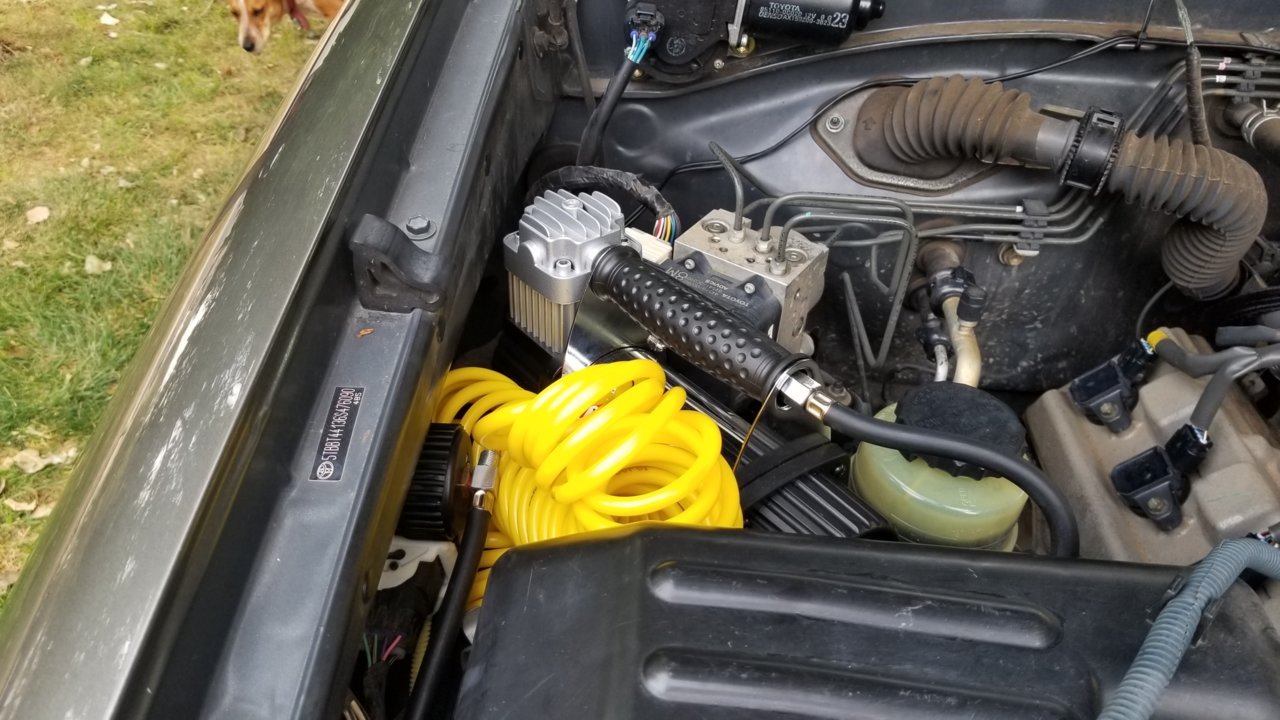

    Didn't try that but it does get warm shortly after the engine starts, so it must be doing something.
    I came up with an alternative. :thumbsup:

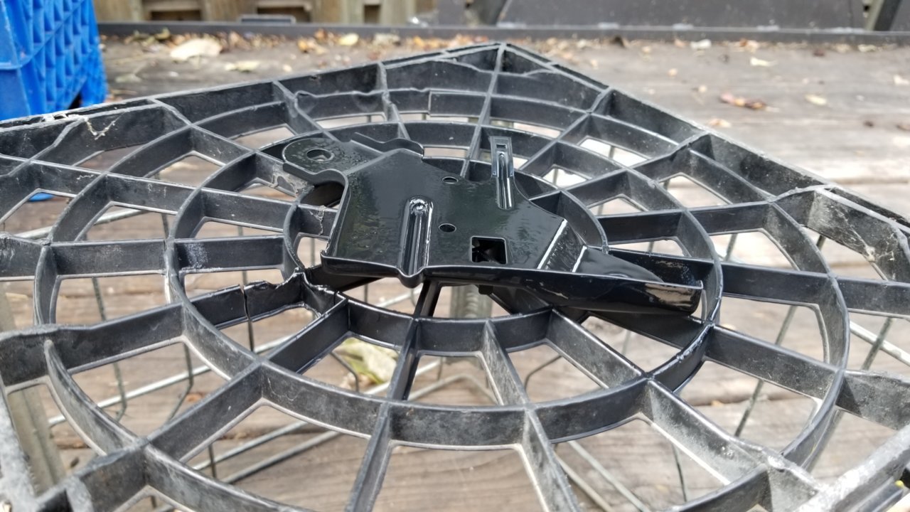

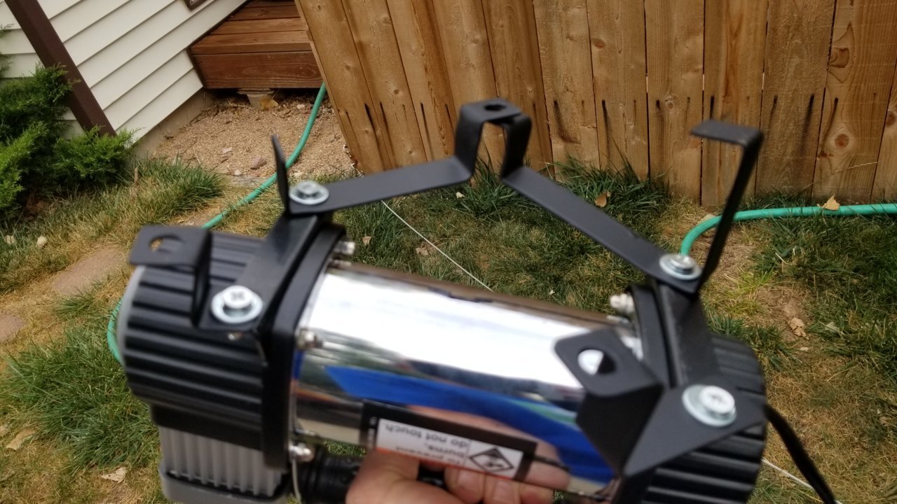

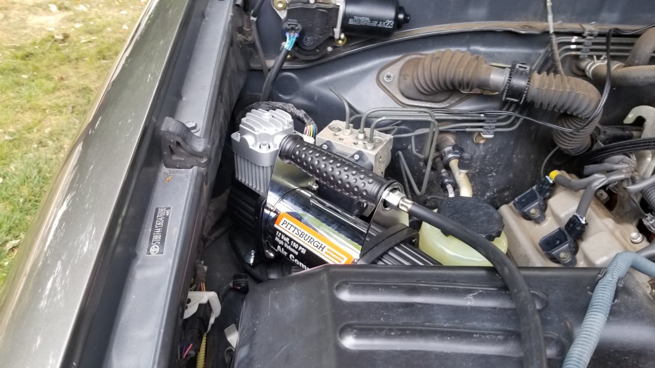

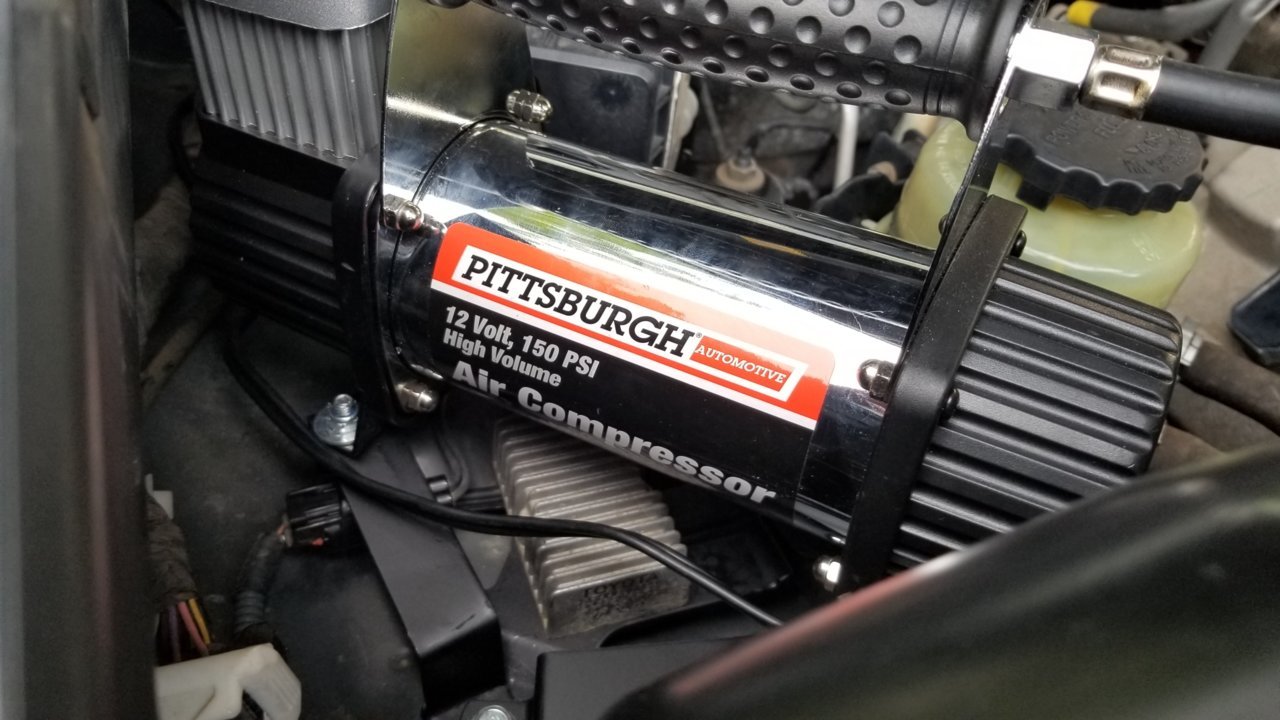

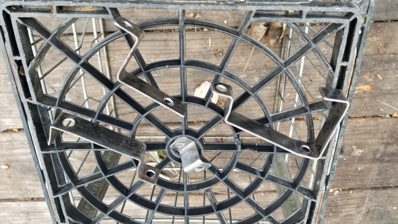

    The vertical portion of that bracket was in the way more than anything.
    So I cut it off and repainted it.
    And made my own brackets to mount the compressor above that resistor or whatever it is.
    Solid, no movement.
    done.
