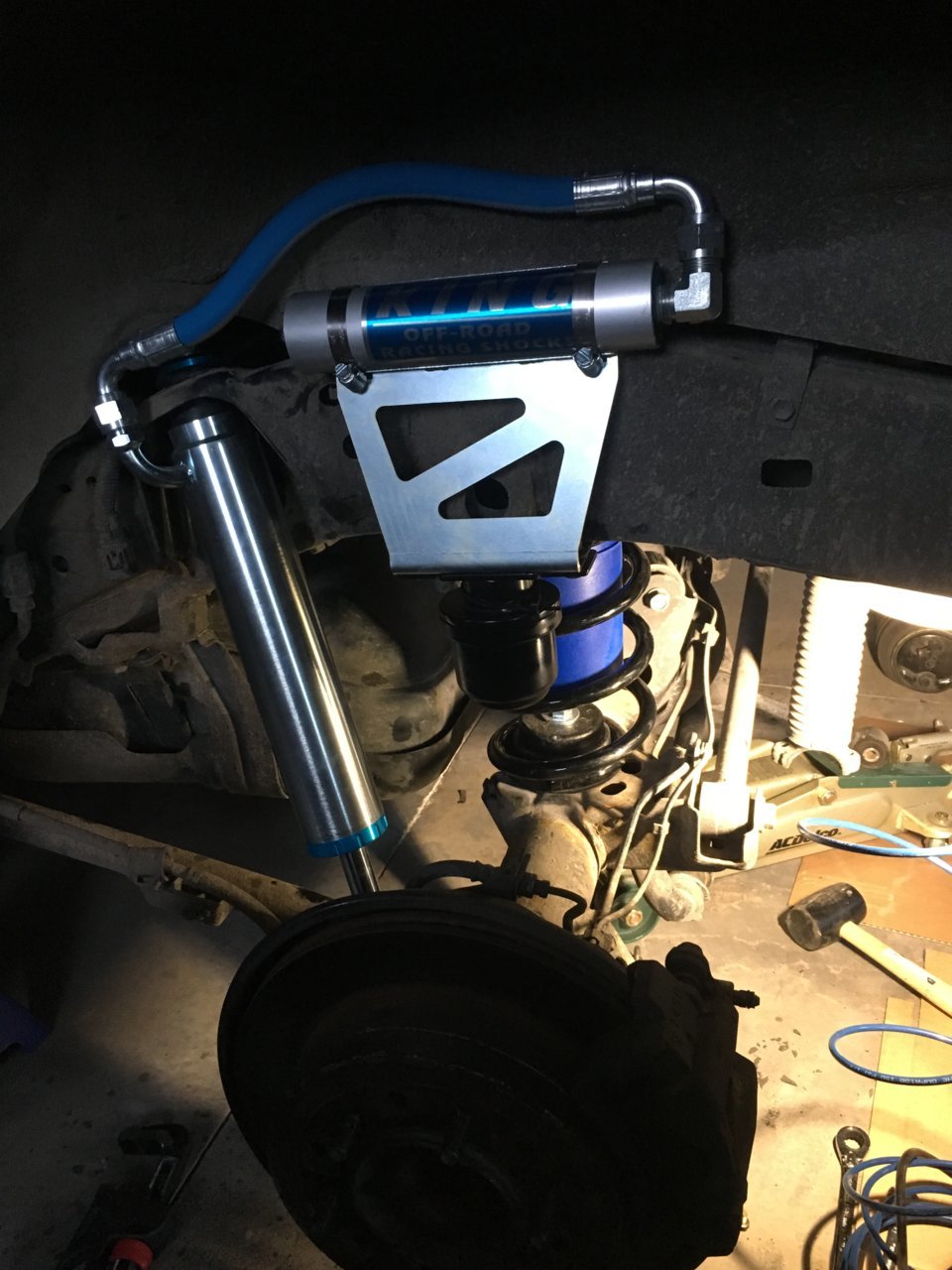

    Yeah, bolted everything up the same. Right when I connected the upper joint I noticed how far off the toe was and the first thing I thought was the steering was turned. Then I went over to the other side and went :annoyed:

    Very normal for the amount of lift you ended up with. Spin the outer tie rod out to get the toe close to get an alignment.

    Sweet, I have one side left in the rear and then it will be done.

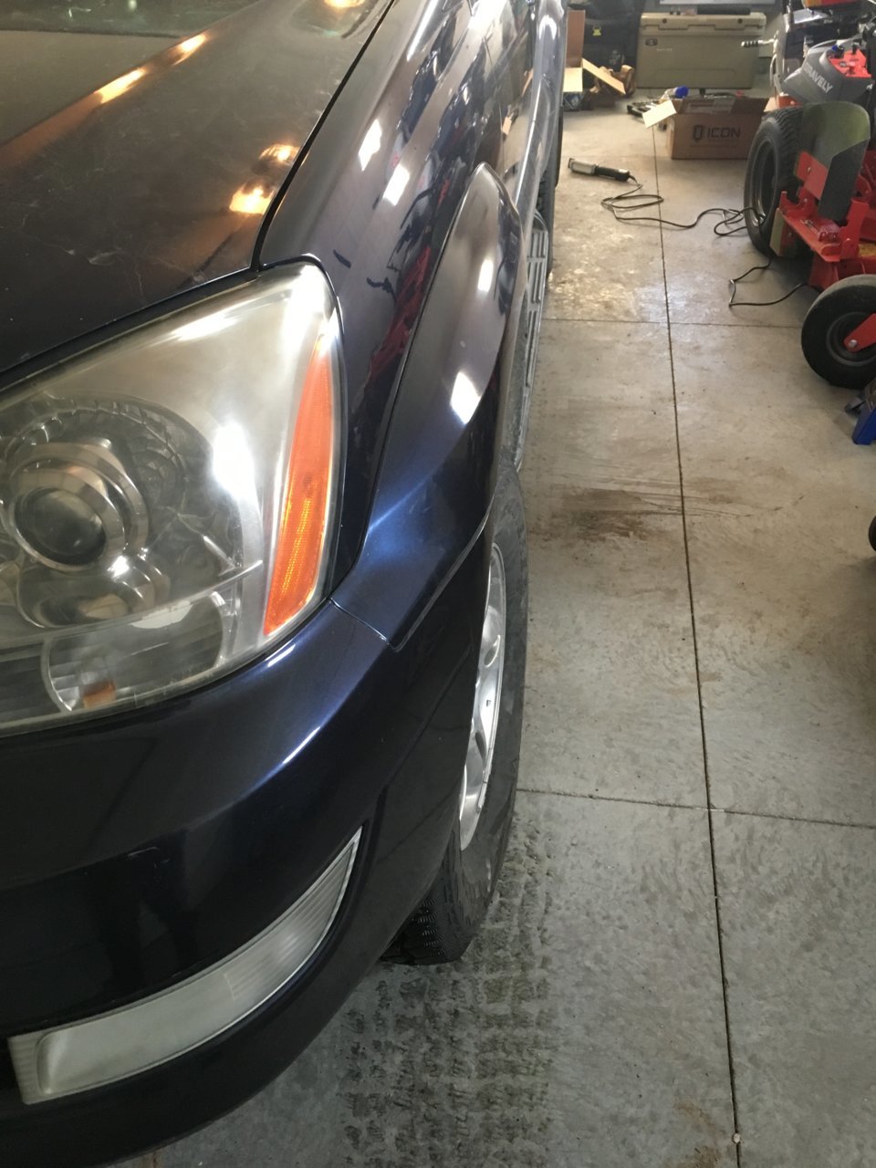

    Also I will definitely buy a vehicle from Florida again. There is practically zero rust on this thing.

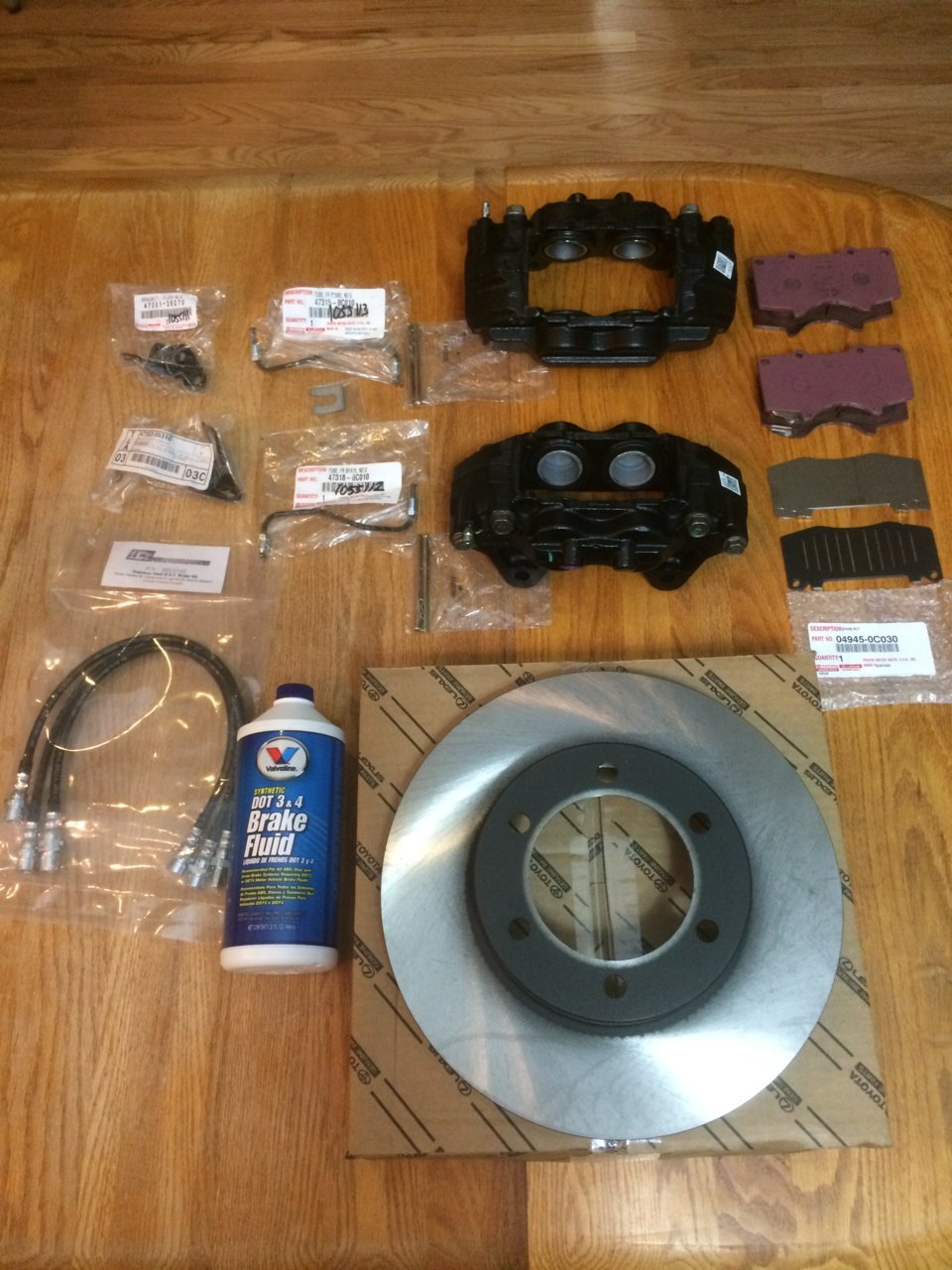

    Time for the Tundra brake upgrade:
    Restore the braking power lost from the addition of armor and heavier tires.

    I can't wait to do this upgrade...
