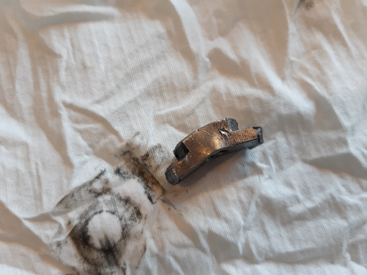

    The bushing can't be removed the same way as the roller bearing?
    Why does the bushing need removed?

    I guess not. The needle bearing will come out with a few hits of a slidehammer. This one never moved....
    We were swapping it for the newer design. He still had some vide and after realizing he had it in there already we set out the swapping it. The new design has more bushing area as well as being longer.

    I didn't use a slide hammer on the roller bearing.....
    The threads on the tool slowly pull it out.
    Is this a different kind of tool? Or are you just using it differently?

    We tried the removal tool last, but because that bushing had more of a steel lip in there it bent the tool....
    I’ve used a slide hammer on then needle bearing before. Last time the tool broke and w e had to get the needles out still. 2-3 good hits with the slide hammer and it’s out

    Could you get a hack saw blade in there and make a cut in the bushing first?
