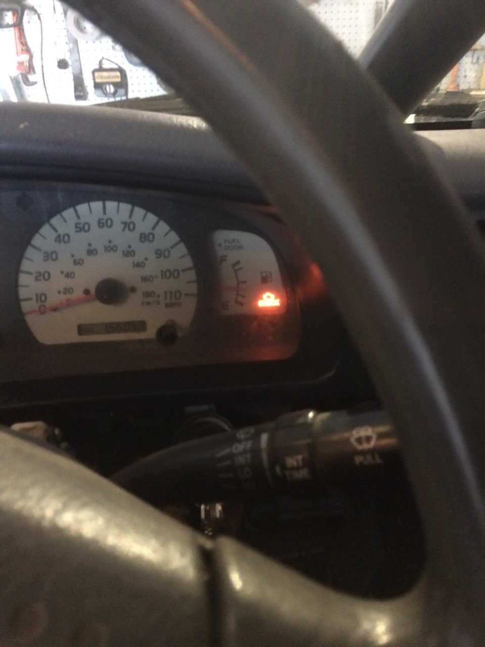

    Fail! At least I tried. But it isn’t blinking anymore more.

    Electrical tape

    That light was on so often in my old Yukon that the bulb finally burned out. Just after that, though, the oil pressure light came on...then I bought my first Toyota.

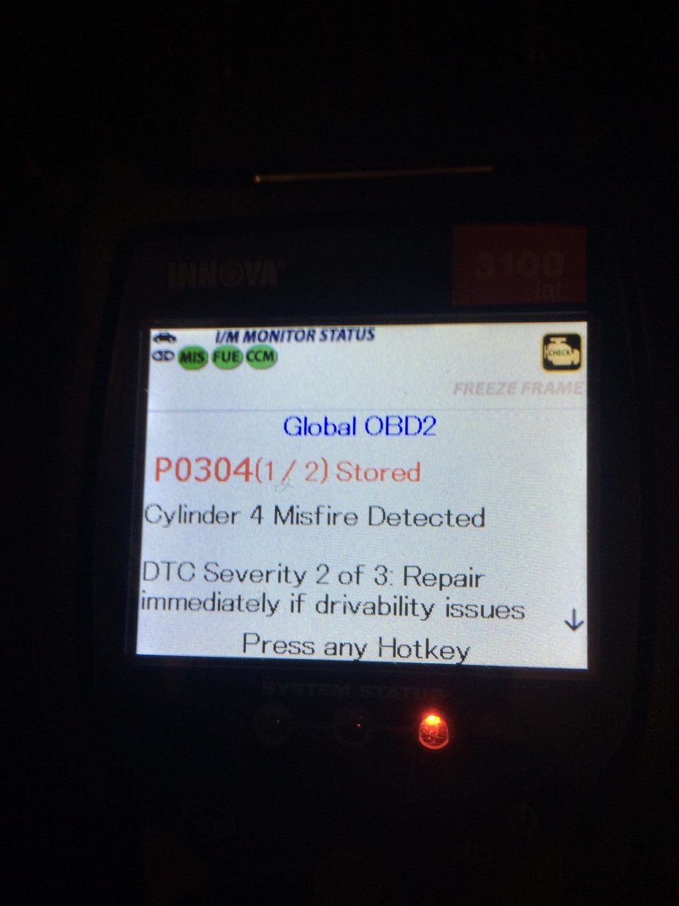

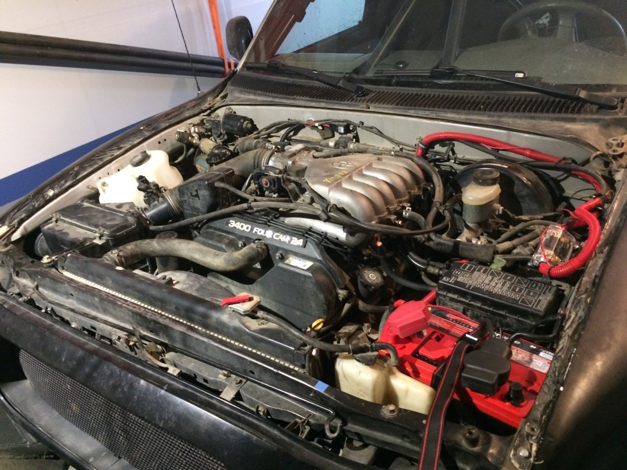

    Here's what happened. I turned on the truck and it seemed to run ok. No check engine light. I turned off the truck after 10-15 mins of idling. I decided to turn it off because I needed to put the hood back on so I can take it for a test drive. After I got the hood on I tried to turn on the truck and it struggled to turn on. I had to hold the key longer then I should to get it started. Once it started it idled like shit and I noticed the ckeck engine light. I ran over to auto zone and got a scan tool and the tool said P0304. So now it's saying I have a misfire on #4. At least now I know which cylindar is acting up. It's the coil pack that had corrosion on it. I'll most likely get new coil packs. I still haven't done a commpression test yet.

    Move the coil pack and see if the code follows it.

    Swap packs, clear code, restart.
    If code indicates new location, you've solved it pretty conclusively and can get a new coil pack.
    I got one cheap from rock auto and it's been doing fine for maybe a year so far? :fingerscrossed:

    Yeah I thought about that after I returned the scan tool. Kind of kicking myself in the ass about it. I was in a hurry with the scan tool. If I swap it now I have no way of testing it to see if it moves to another cylinder. Plus Dylan and I are going to do a compression test prior to getting new coil packs.
