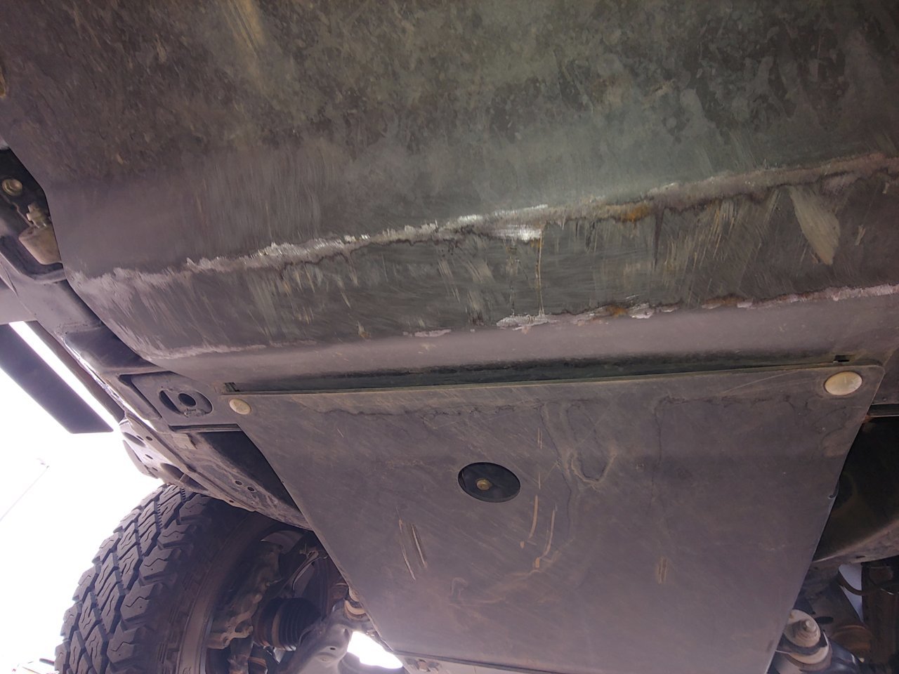

    Doesn't someone make a "fix" for the shitty routing of the 3rd gen exhaust where it doesn't drag on the freeway at ride height?

    I talked about this with a guy named Sean @ Exhaust Pros in Northglenn the other day. Said he's done a bunch of them, and quoted me $150 to do it. I bought the "exhaust reroute" t-case skids, so it has to happen before the skids go on in a few weeks.
