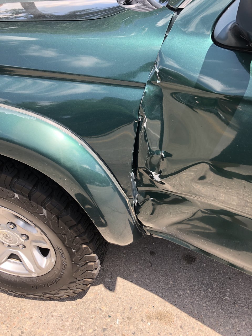

    Any best gen guys have any tricks to getting the front doors off? The driver’s side door on my third gen 4Runner was basically ripped off by a fifth wheel in old town FoCo yesterday. GF was street parked with tires touching the curb, dude switched lanes as she was opening the door, trailer swayed nearly sideswiping the truck ripping the door out of her hand and bending it all the way forward. Nobody was hurt, thankfully! Found a door at Yota Jim’s today and am looking at swapping it on tonight. The door panel is cake, just looking for advice on the actual door. @jubei @Deathbysnusnu @Squeaky Penguin @TMFF @thefatkid @SilverGhost
    Any help is appreciated!
    And yeah, fender is jacked too, but I’m not worried about that at the moment. The door’s bent so bad it’s not even close to shutting.

    Pull the inner panel off, un clip the wiring loom for radio, locks, etc
    Then it’s a pin for the door “catch” and then 4x14mm or 12s can’t remember.
    Can be done with one person and beer

    The bolts are all under the front fender and easy to get to, 6 total I think.

    Thanks Guys! Looks straight forward, just didn’t know if I was overlooking anything. Appreciate the help!

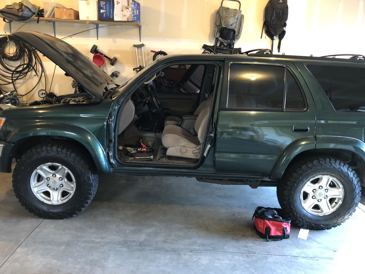

    Thanks @crolison and @TMFF real easy! Just waiting on the new door. I kinda like this look. Bob the rear, cut off the top and make it a crawler?

    Got it done. Alignment was a bitch and thankfully we took the hinges too because the original ones were tweaked pretty bad. A couple issues with this door, but I’ve got the old one I can swap parts out of if I have to. It’s driveable, so it’s good for now. Thanks again @crolison and @TMFF
