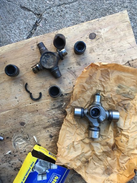

    I'd check your u-joints and center support bearing. If you can diagnose problem as being drive shaft related and don't want to do the work yourself, then Bills Englewood Driveshaft discussed a few posts up might be an option if you pull your drive shaft and bring it in.
    Get under the truck and give your shaft a good tug in every direction. The center support bearing should have some wiggle in it, but it should not be loose. Grab the two pieces of the shaft and try to rotate them against each other in both directions. These should be tight and shouldn't have any play. Each u-joint should have a little rubber seal at the bottom of the cap. Look at the seals around the u-joints for cracks. If the seals are broken or leaking grease, or you see grease splattered on the truck where the joints rotate, I'd replace them.
    In the picture below, you can see one seal is completely missing and the other was cracked on my old u-joints. The needle bearings were all completely gone and the arms of the u-joint started to wear down to a point. This would make a loud knock on acceleration from a dead stop, then vibrations around 30mph.
