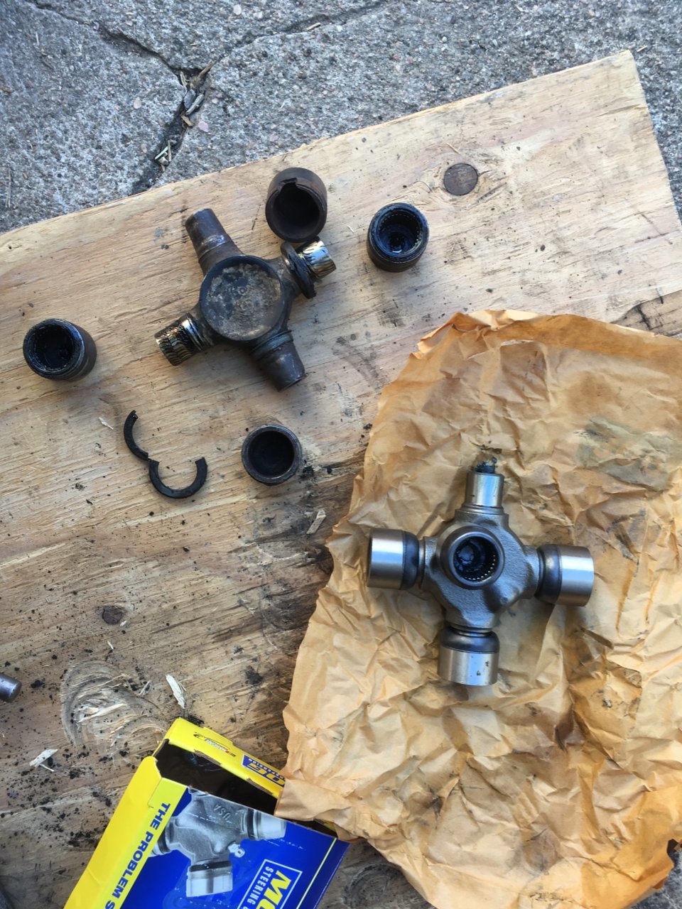

    Look for broken or missing seals on the u-joints, signs of grease slinging everywhere from one being busted. They will typically shed a little grease when freshly lubed, but you don't want to see a thick clump on the body. Twist the two halves of the shaft against each other. You should get just a little movement of the shaft against the ring and pinion in the diff, but the two halves shouldn't have any play against each other...they should be tight. Completely toasted u-joints you might be able to tell while it's on the truck, but you might consider taking it off the truck and seeing how freely they move. If they are really loose, I'd replace them. They should be on the snug side versus totally flopping around.
    For the center bearing, look to see if it's cracked or rotted or separated from the metal sleeve. Push up and down and side to side. There should be a little flex in the rubber, but it should be firm and should not have a lot of play.

    This is what you dont want it to look like...two of the four ends were completely missing the needle bearings and were rounded out. It was loud...the play in the u-joint was obvious. Easy diagnosis in my case...hardcore neglect.
    Is the squealing a separate issue from the vibrations or do you think they are related?
