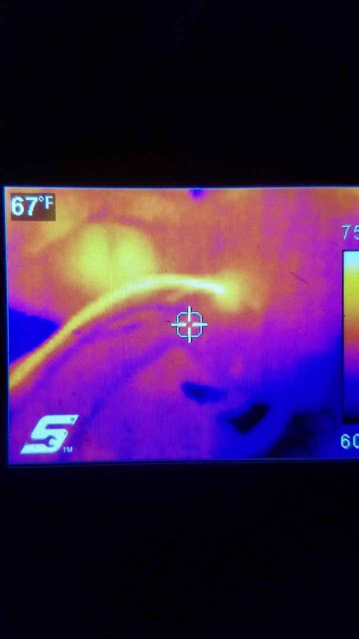

    I believe I have a short. Ign2 fuse kept blowing. The fuel pump wire looked like this. Possibly my fuel pump is shorting or the resistor failed I dunno. There are four wires at the fuel pump connector.
    With the connector unplugged, three of these wires have continuity with the frame. That seems odd. I cut the black with pink wire that was glowing on the thermal cam and the dash lights went away but obviously truck doesn't run without the fuel pump so wtf. Still have a short but not within the wire bundle as I was expecting, rather it is in the fuel pump assembly? Fuse no longer blows with this wire cut

    Can you jump from the Ign2 fuse to the pump? If it still pops the fuse while jumped then it’s in the pump right?
    If it doesn’t pop then the short is somewhere along the factory harness.
