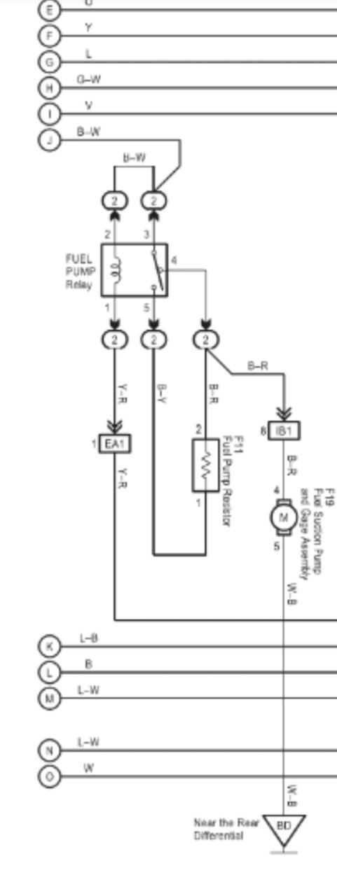

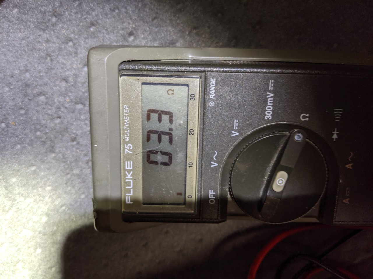

    I unplugged the wire from the fuse block and from the fuel pump and tested, no continuity to ground so I believe it is in the pump, not the harness

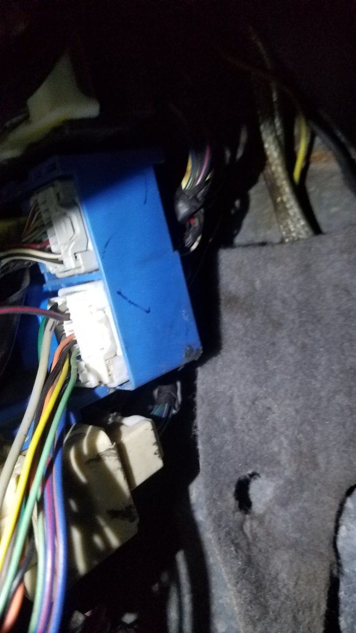

    According to this, the black with red (the one I'm testing) goes through the pump to ground on the other side....so that kind of makes me think that I made a mistake and the wire should go to ground. Anyone want to pull out this bottom white plug in their truck and see which wires go to ground? Drivers kick panel

    First of all, the bed appears to be missing...unless he's testing a cloaking device to avoid being spotted

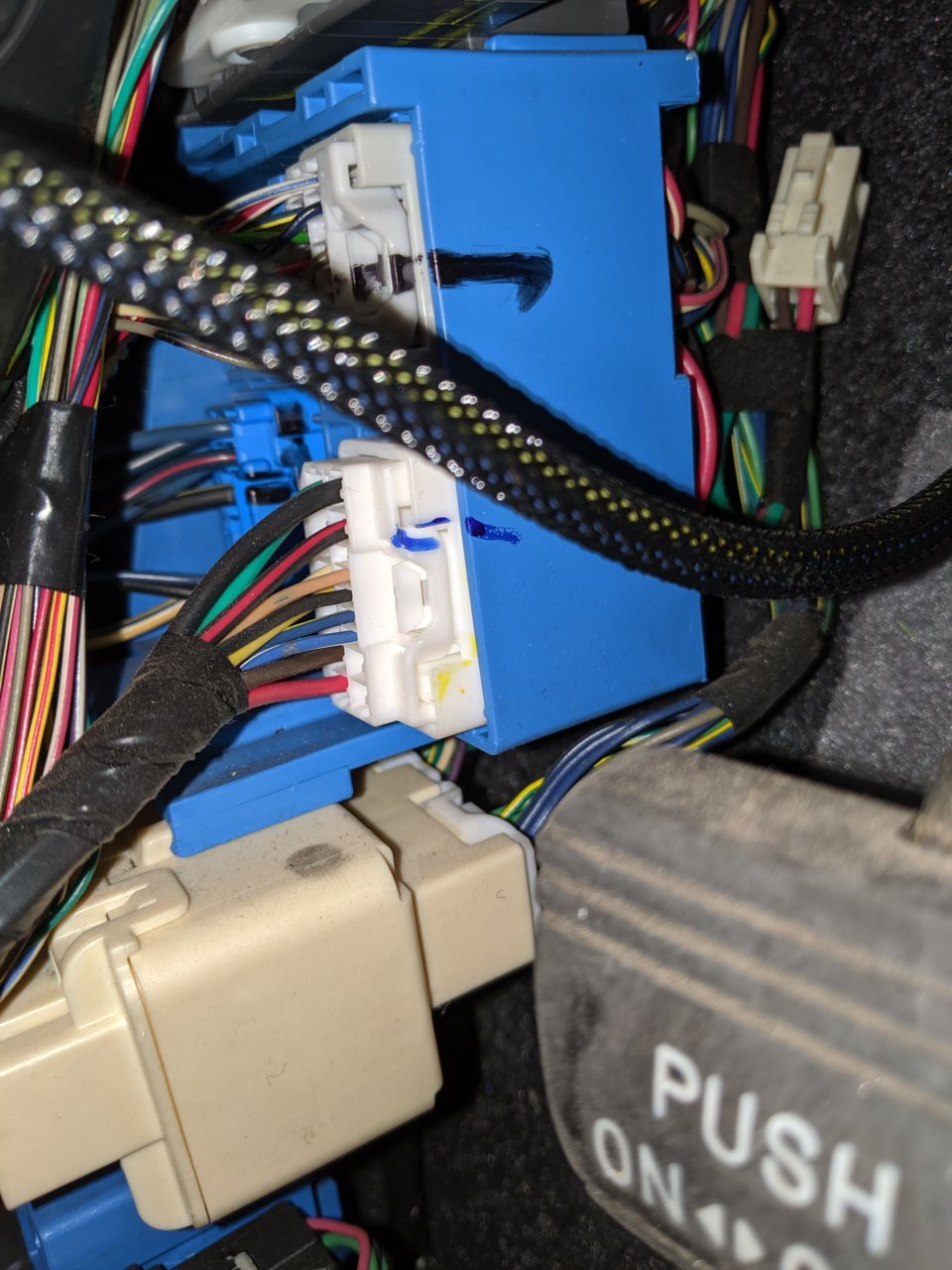

    Hey Ryan I'm at home right now. Pulled the panel and took a quick pic of the plug, what exactly do you want me to check? BTW, mine is an 09

    Hell yes thank you, that black wire with the red stripe. Disconnect that plug and check if that side of the wire that goes toward the fuel pump shows continuity with ground

    Yep

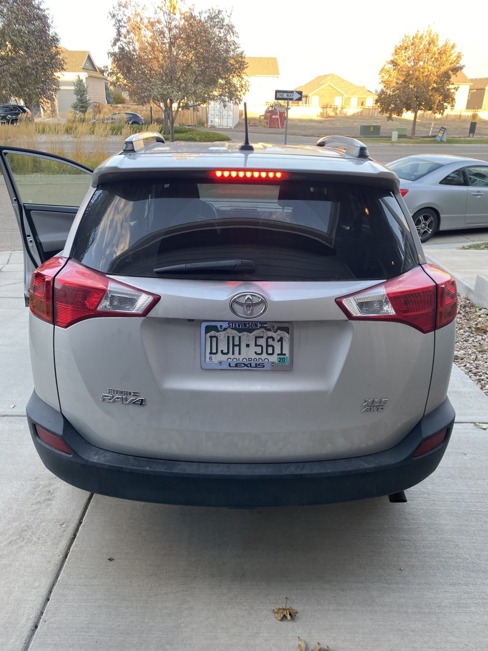

    Anyone run into this issue?
    2014 rav4 Bottom rear brake lights Won’t turn on when I brake? I have checked fuses, bulbs Replaced and the brake switch seems fine if it was bad I don’t see How the top light Would work?
    is there a relay that can go bad that causes this?
    @thefatkid
    fixed loose connection
