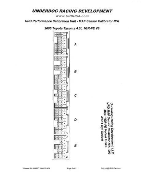

    anyone install a URD MAF Sensor Calibrator yet on their trucks?
    just got mine in the mail today and trying to grasp the wiring that lies ahead of me...

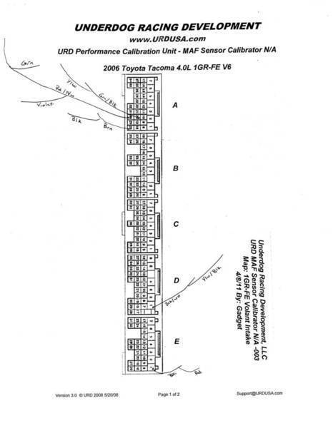

    the connections A-D seem straight forward but idk what they are trying to have me do with the green wire in Connections E&F....
    same page with my notes on it..

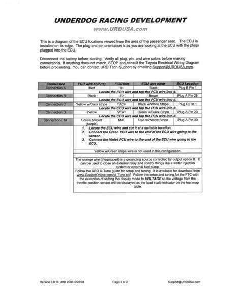

    "1. Locate the ECU wire and cut it at a suitable location
    2. Connect the Green PCU wire to the end of the ECU wire going to the sensor.
    3. Connect the Violet PCU wire to the end of the ECU wire going to the ECU."

    wire going to sensor _________>wire to PCU[PCU]wire to PCU>______wire to ECU?
    if that makes sense in my verbal/symbol explaination

    Bob, I have one installed on my truck. It sounds like you got it right. You cut the ECU wire and then connect the end going into the ECU to the maf calibrator. and the other end of the wire that goes to the maf sensor is also connected to the other wire going to the maf calibrator.

    awesome...thanks man...with something like the ecu, i didn't want to mess up my wiring going on assumptions alone

    Yah, don't mess it up. and make sure you disconnect the battery before you start working on it. Theres some weird thing where the ECU doesn't actually run out of juice until about 20-30 minutes after you disconnect the battery. So make sure you don't solder super fast and finish in less than 30 minutes :p

    what happens after 30 minutes? does the bus blow up?

    the ecu resets. if you don't unhook the battery, then when you turn on the truck the ECU will shit a brick.
    happened to me before haha.

    but if i disconnect the battery i will be fine, right?

    Yep, good to go
