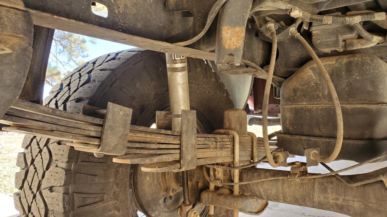

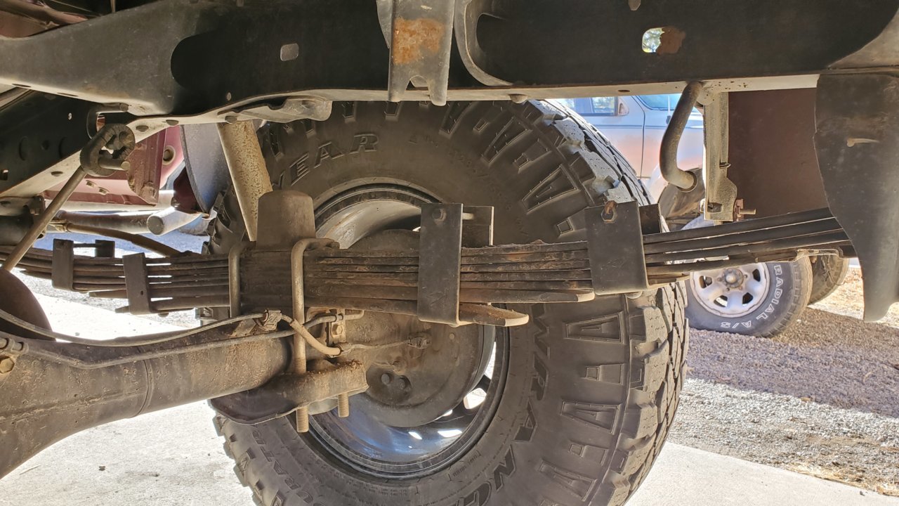

    No those look pretty fucked. The s curve shape sez they are shot in my professional opinion

    This is what I'm thinking. This is the email (removed order info and personal info) I attempted to send ARB USA but conveniently their email for warranty seems to not be working. I keep getting a error message from their end. I'll update everybody on how they plan on handling this, but not looking great as it appears they tend to find arbitrary reasons to avoid warranty from a quick web search.
    "On 11/25/2018 I ordered a set of OME Heavyload EL096R leafsprings from Low Range offroad and installed on December 10, 2018. Shortly after I noticed after I noticed that the springs appeared to be settling much lower than anticipated. I contacted Low Range and was informed that I would have to take it up with arb. Upon contacting arb I was informed that "it was normal settling". Fast forward to now and my leafspring appear to be developing a reversed arc. My truck is my daily I do not tow and besides my Allpro bumper and spare tire I rarely carry any additional weight. I have pictures I can send you. Please someone contact me regarding this issue."

    I have the Dakar HD's. Had them 7 months. Also seem to have that negative curve in them
    Maybe 300lbs on the back? Bed rack/RTT/spare tire. No bumper

    So I contacted ARB this morning and talked to Jacob and after explaining the situation i was told this is "normal" but they would be willing to take a look. Now I havent gotten a response back yet but based on ARBs initial response it doesn't look promising. I also contacted Low Range offroad to get their take and talked with Jesus and based on the same information he says something doesn't sound right.
    Will keep you guys posted.

    Talked to a local shop owner this morning also and he's saying the same most everybody is "something is wrong" he would expect that from a tired set of springs that were worked hard but not on a set of 14 month old springs on a light weight tacoma. Hell most the weight is on the front (arb bumper, winch and front skid plate) which would actually alleviate some of the rear weight.

    I've seen this from a bunch of ARB/Thick pack leaf springs on the back of Tacoma trucks. Measure from the axle tube to the bottom of the frame and confirm lift height compared to a stock truck.
