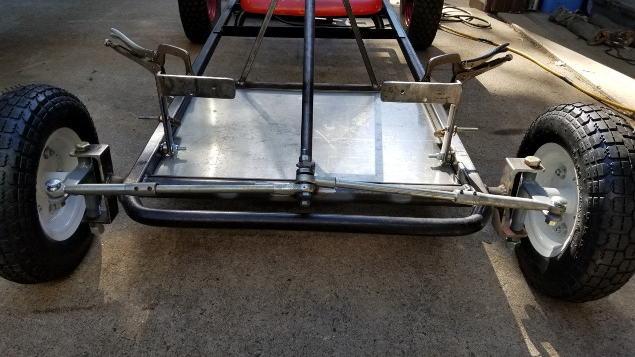

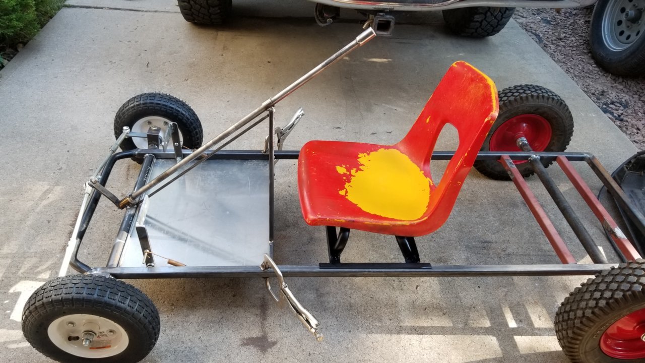

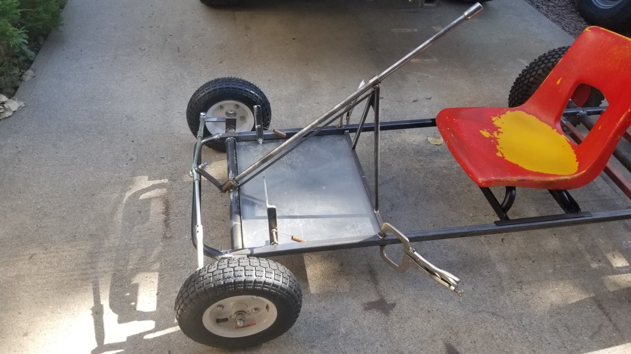

    Had the sheet metal sheared down to size today, there is another longer one that will extend back under the seat, but I may leave it out as I like the open floor look.

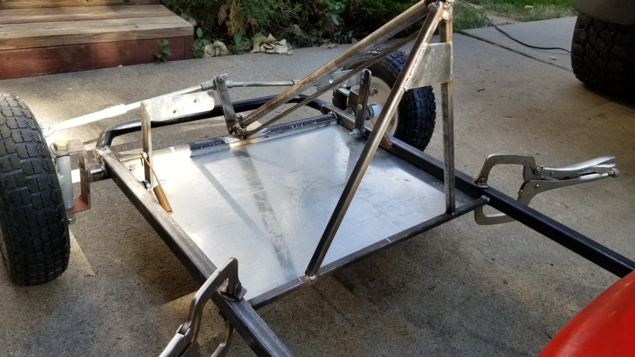

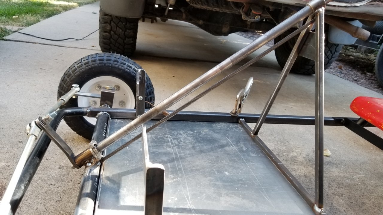

    also made the steering column and the seat mount, which is adjustable. :burp:
    dashboard for the kill switch.
    the hose clamp retaining collar is temporary until I feel like making it cooler.

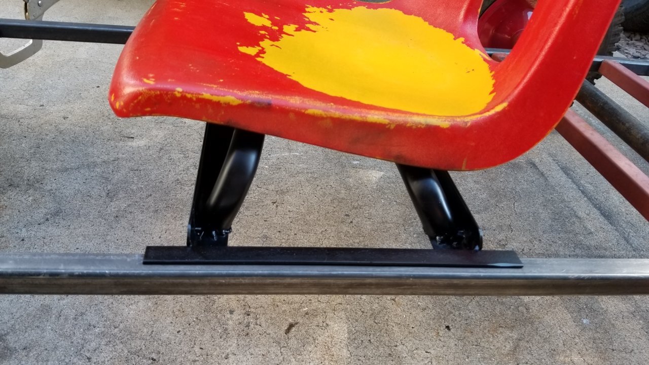

    the rails are pretty tight between the frame. I'll prolly just drill and tap a single hole on each side in the center and and get some cool threaded knobs to hold it down. If i need to adjust it, I can drill another set of holes. Totally adjustable.
    all the way forward.

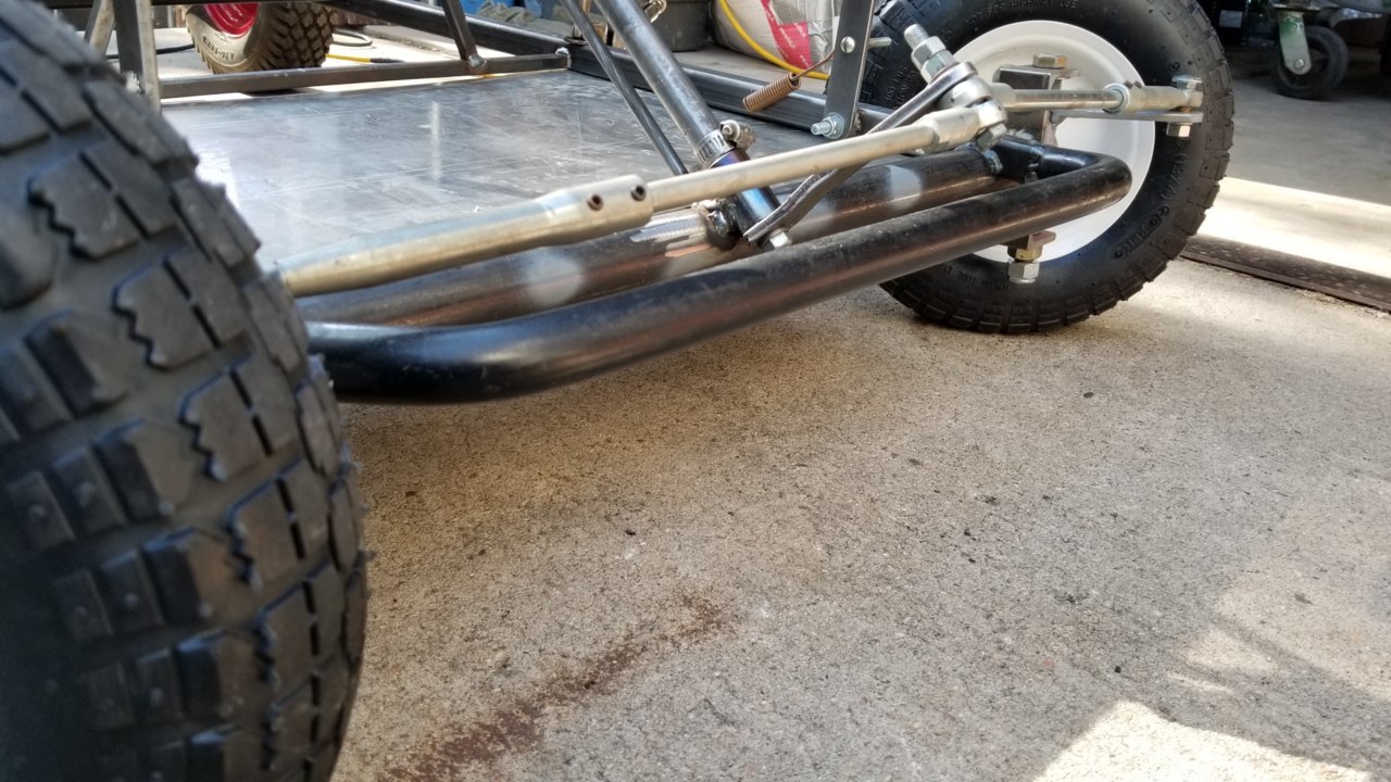

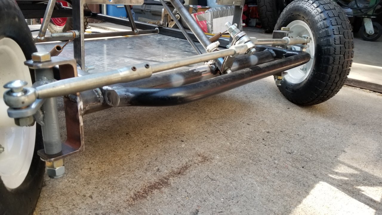

    plenty of tie rod clearance

    Looking good! Who is building one next so he has somebody to race?
