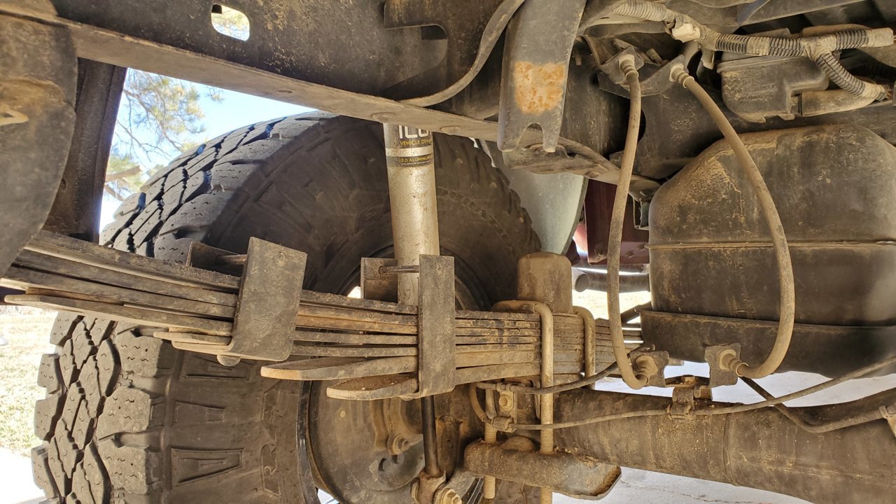

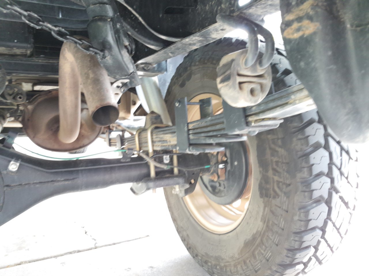

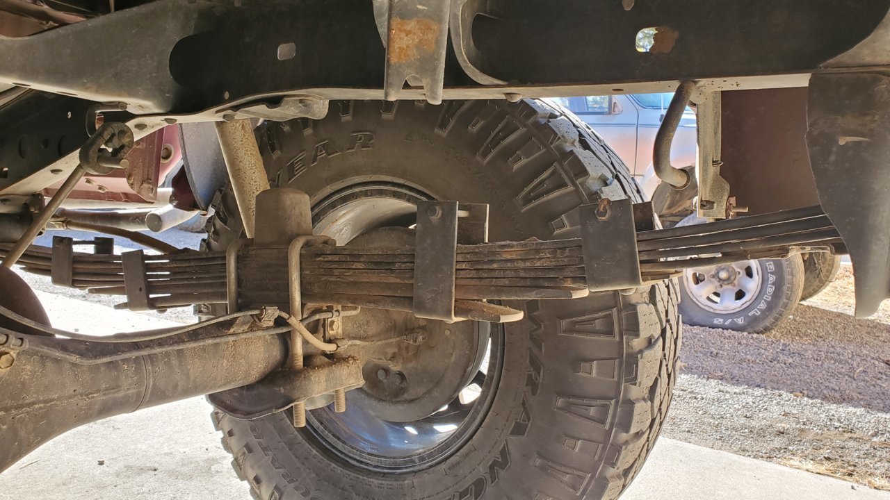

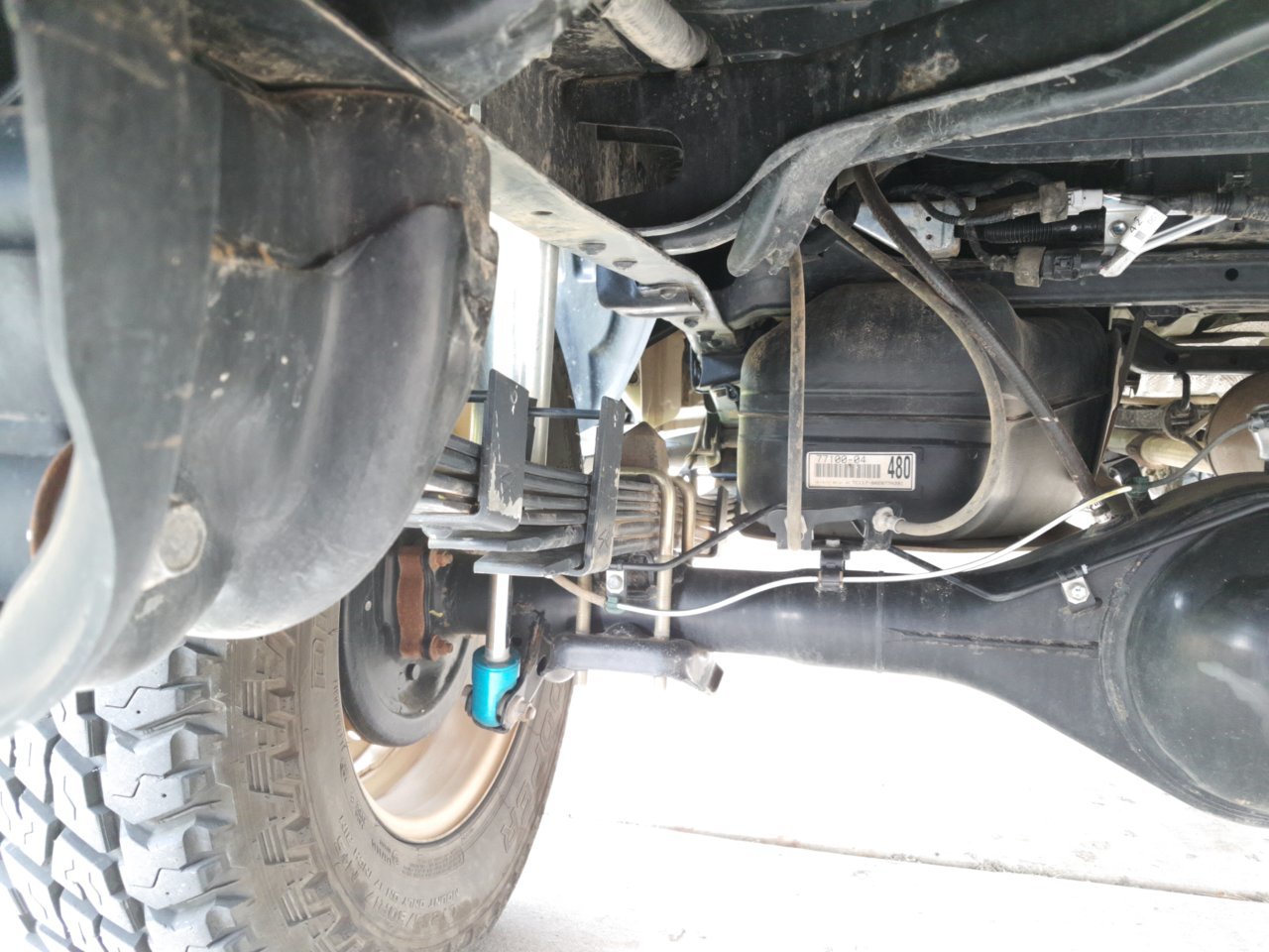

    I'm to lazy and go back through all my posts but yeah I posted this issue back in February I think. Good luck dealing with ARB. They basically said its normal and then stop answering my emails and calls. For reference my are the HD leafsprings.20200202_121704.jpg 20200202_121651.jpg

    Toytec gave me a leaf to add to the hd pack they sold me that was doing the same thing 5 years ago or more....... Y'all ready to try and do a group buy with alcan?

    both of your bump stop setups appear to allow for significant negative arch at full bump. This is likely a contributing factor to the shortened lifespan and sub par performance. My understanding is negative arch should be avoided whenever possible which is difficult the way taco rear ends are set up

    While true these leafpacks are designed for tacomas as a direct replacement. If they had designed them to be used with a taller bump that should have been listed in the description on their website.

    Common problems with those leaf springs on the 2nd /3rd gen newer Tacoma.
    If it was an early 1st gen, you'd have an awesome stance.
