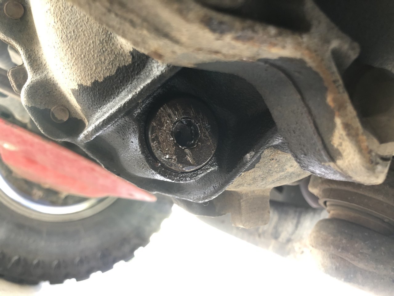

    I said I wouldn’t do it... and I did it.
    I stripped my front differential plug :annoyed:.
    I’ve ordered a 10mm 1/2” drive socket and a newer BETTER plug. Anybody on the south side of Denver able to weld the socket onto the plug for me next weekend?
    :welder:

    I like to pretend I can weld. Depending on day and your availability to come to the 80015 I could do it for beers
    We can probably save your socket and weld on nut from my scrap bucket too.

    I had this happen to me was able to use a torx bit and a hand held hammer impact to break it loose. if you need i have a spare factory plug. I upgraded too one of the 14mm socket style vs 10mm allen. Let me know if you need it!

    Thanks for the offer but I already have a new one on the way. Instead of a recessed socket, it has a 14mm hex so I don’t make the same mistake twice.
    Toyoya 90341-24016 PLUG, STRAIGHT SCREW https://www.amazon.com/dp/B01F7MAXX4/ref=cm_sw_r_cp_api_fabt1_5dYUFbYRW9KGP
