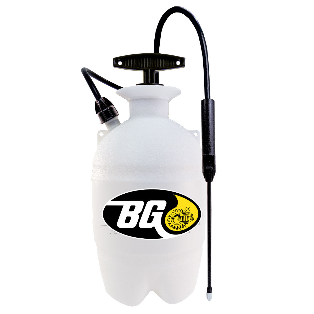

    So, my "Gravity Drain and Fill" technique for both Transmission and Differentials is good to go?
  12. Jan 21, 2021 at 8:00 AM
    teamhypoxia
    teamhypoxia MichelinMan
    Aug 21, 2012
    #85247
    9,693
    Colorado
    '12 DCSB TRD OR
    I guess......
    I mean if you want to be "In the industry"
    and "know your shit"

    I mean if you want to do a bunch of drain and fills, that is really similar to our refill tanks. The "flush" does a little better job of keeping the fluid mixing down. BG claims 90% new fluid compared to about 60% for 5 drain and fills (both 16quarts total). I actually argued this with one of the reps when our dealer went to their systems. We went to the BG training facilities in Golden and they proved their system to me on a co workers and my car of the difference was noticeable. Worth it? yes. I would gladly see a person doing it the manual way though as long as they are doing something.
    They call it lifetime fluid because when it fails so does the transmission, if it made it out of warranty it lasted their intended lifetime.

    "Drain and fills" would mix the fluids.
    I disconnect the lines at the cooler and use the trans to pump out of one and the sprayer to pump in the other.
    I don't quit until the fluid coming out looks exactly like the fluid going in. I'll defer to @thefatkid but I doubt there's much mixing going on this way. In fact, it sounds exactly like the poor man's version of his BG machine.

    You must have mad pumping skills. I understand, many years of marriage and kids. I approve.
    That is a very similar method. If you have a difference in fluid temperature they will resist mixing even more.
