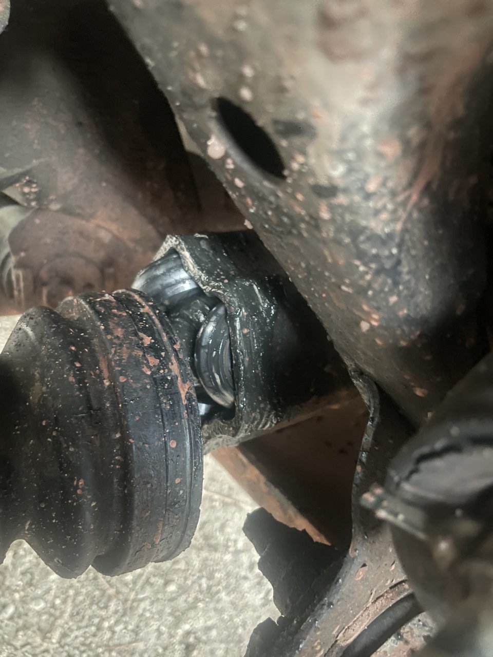

    Anyone know why the cv axle rides so far out on the inner joint? 3A5CE4DD-1DD0-4B17-81CF-3F3F28668C9C.jpg

    Looks a bit short, is it the right one for your truck? I saw your exploits in the trip thread, was wondering it was a replacement at some point.

    No, it has been the original axle that came with that diff when I did the 4wd conversion.
    normal driving has been fine but after this trip it’s piped out 3 times on trail..
    from what I can tell there oem axles

    Dumb question, but is the front diff actually centered? How does the other side compare for length?

    Bent spindle? Diff not centered?

    Both sides(CVs) are the same length but the diff is not centered.

    Shouldent be, there both gusseted. can’t see how it wound get off center when there’s 3 mounting points, but havent had the time to check it today.
    Wondering if the spc uca is all the way out and so is the lower rear cam tab. Maybe it’s pushed too far out?

    Hmm I guess it's possible. Let me know if you want a hand with the diag
