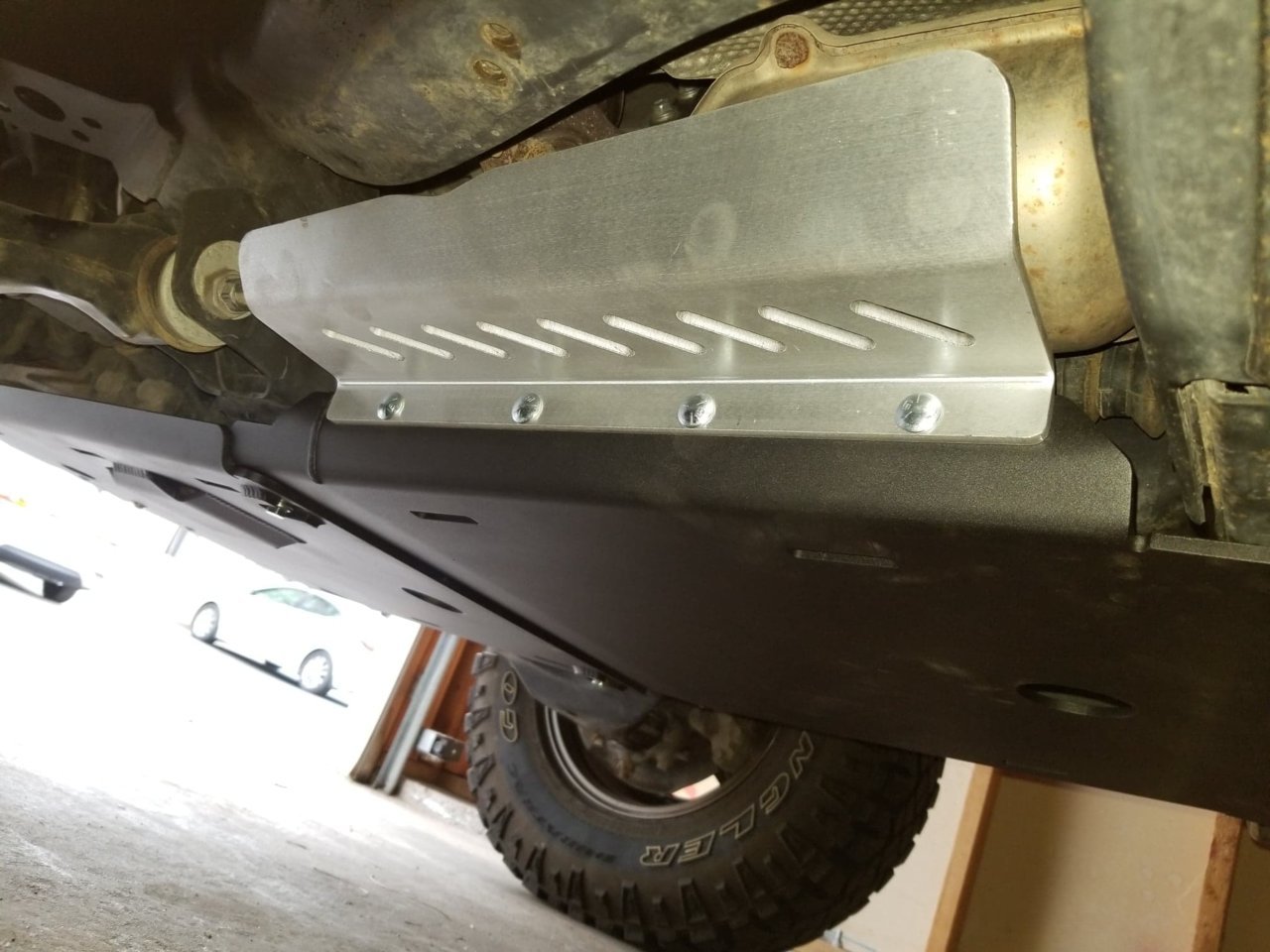

    Im getting an aluminum skid to thwart the catalytic convert thieves.
    Do you guys paint the aluminum the same as steel? Same process?
    Green pad/ acetone/ primer/ rattle can
    Im to lazy too google, plus you guys are real life experience.. :D
  2. Jul 9, 2022 at 10:20 AM
    Wulf
    Wulf no brain just damage
    Jan 30, 2015
    #147523
    61,413
    rock raisin
    Self etching primer for aluminum but yep you got it

    Tacoma's are relatively low on the totem pole for CAT theft. As long are you don't own a hybrid or Honda CRV, Hyundai SantaFe/Santacruz/Tucsan (Basically any compact SUV the has easy access underneath and some hybrid tech), shouldn't have much to worry about.
    That being said, I support your skid decision anyways lol

    Which one are you getting? I went through the research process and then finally secured a parking spot in a locked garage, so didn't follow through getting one.
    Relatively low, but the ease of access and having four cats on a 2nd gen (and maybe 3rd gen) make it still worth a thief to try to get them.

    Talons Garage
    He is a vendor on here and its a bolt in, so fairly easy install

    Ah, I didn't see that one in my research, but it looks like it actually does cover the cats, unlike some other "cat shields" and definitely way more than some people's ideas of just getting the RCI trans skid, which still gives you 98% access to the cats.

    With the RCI trans skid cat protection add on, I think they're pretty well protected.

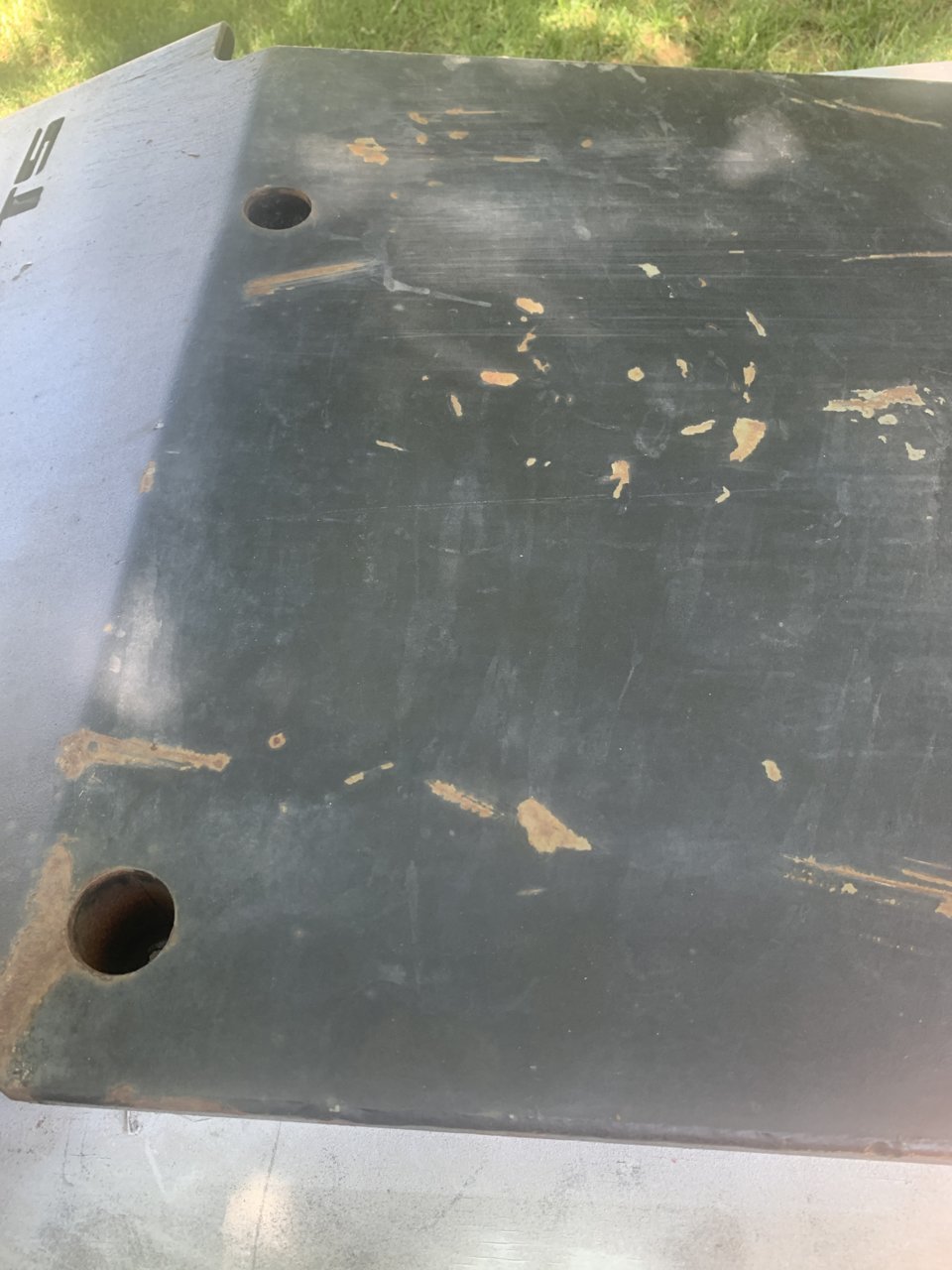

    So if i wire wheel these rust spots off.
    Do i need to primer before rattle can??
    Wulf likes this.
  18. Jul 9, 2022 at 1:36 PM
    TXTaco13
    TXTaco13 Taco/T4R Enthusiast
    Aug 25, 2013
    #111175
    6,936
    Dallas, Texas
    4TH GEN V8 4X4 T4R
    '83 CJ7 '19 MT 07
    Primer it. Epoxy is the best, or self etching
    Did you use pilot holes? What size drill bit?

    I had a feeling
    Thanks :D
