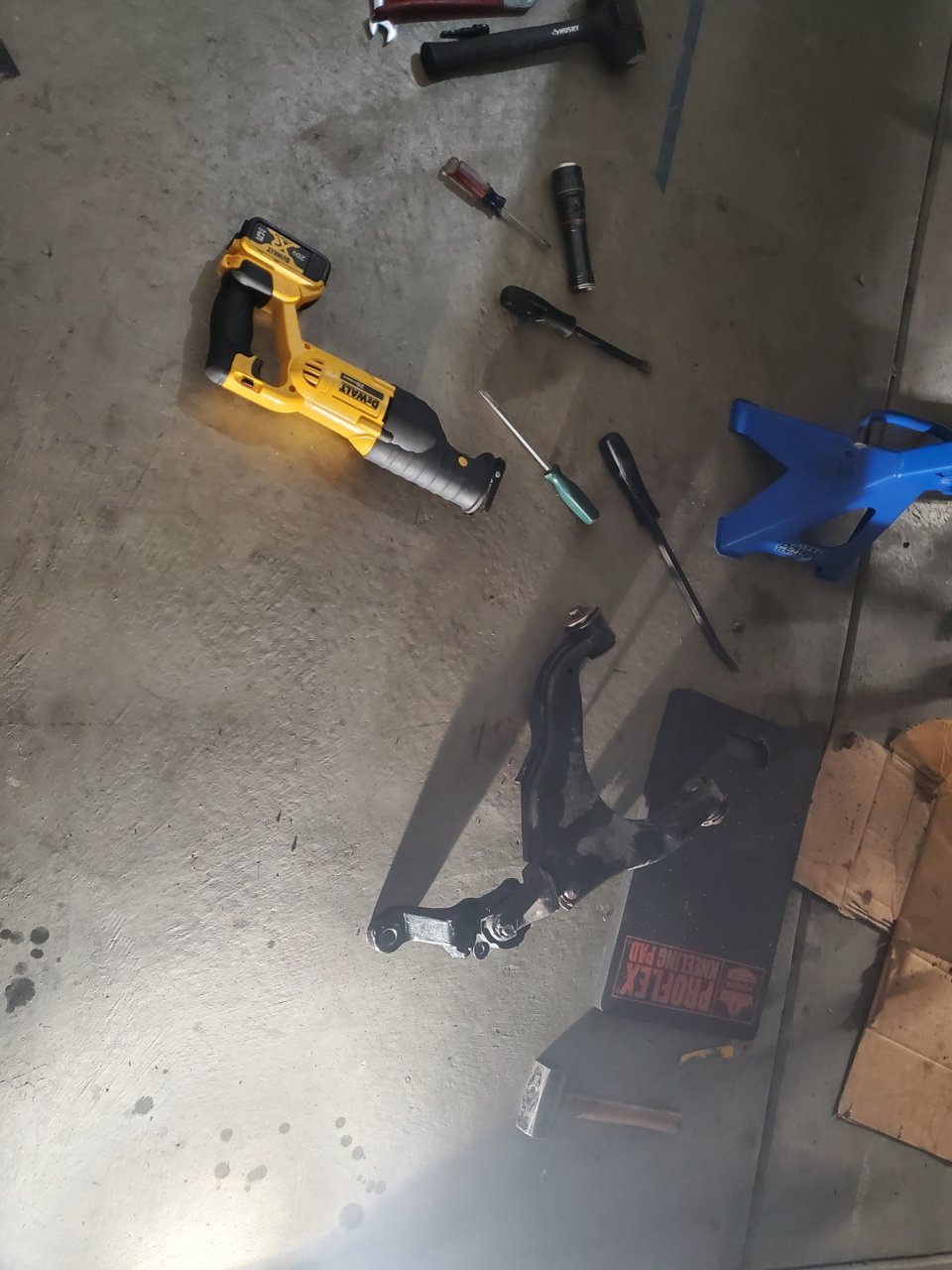

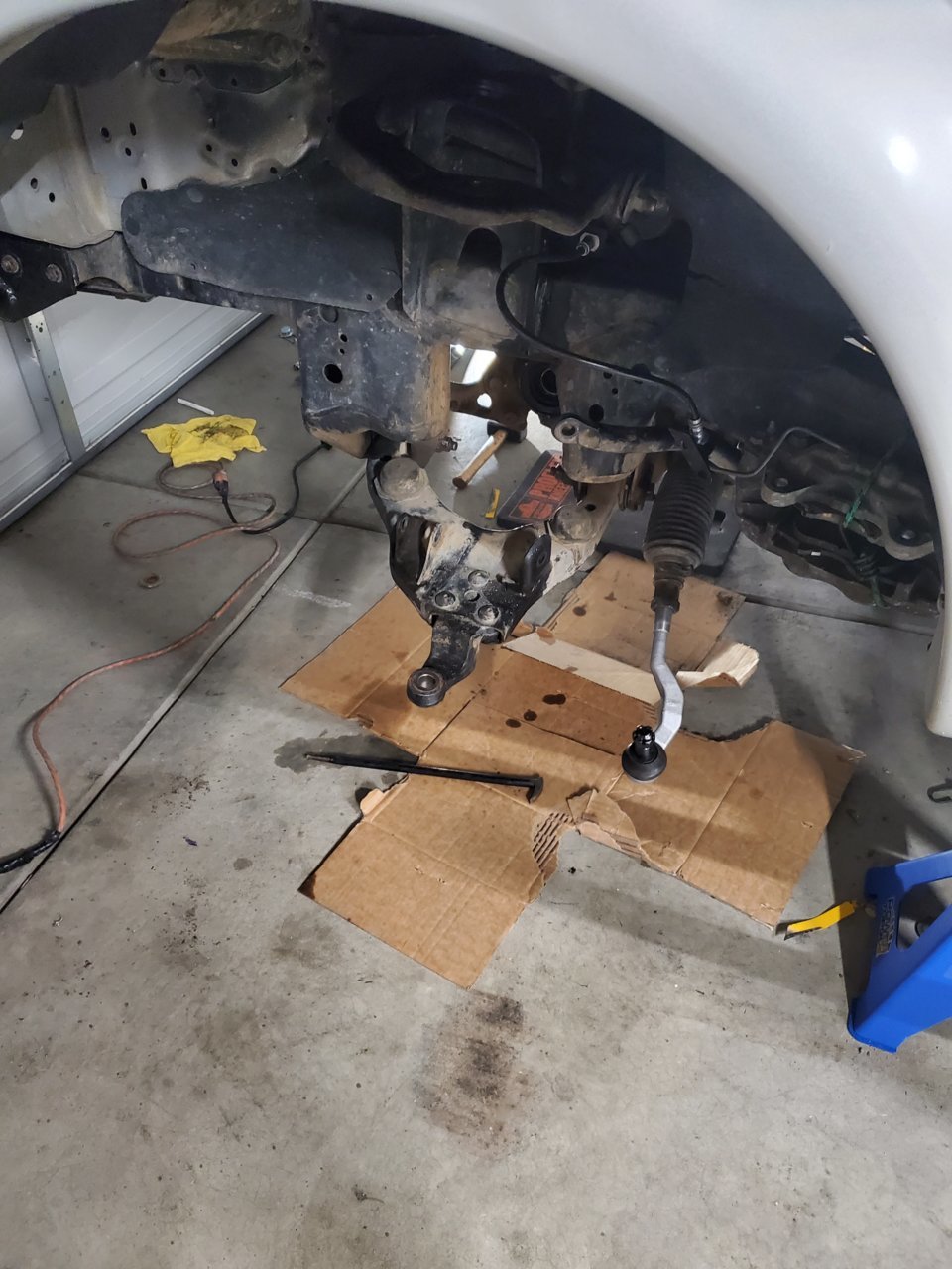

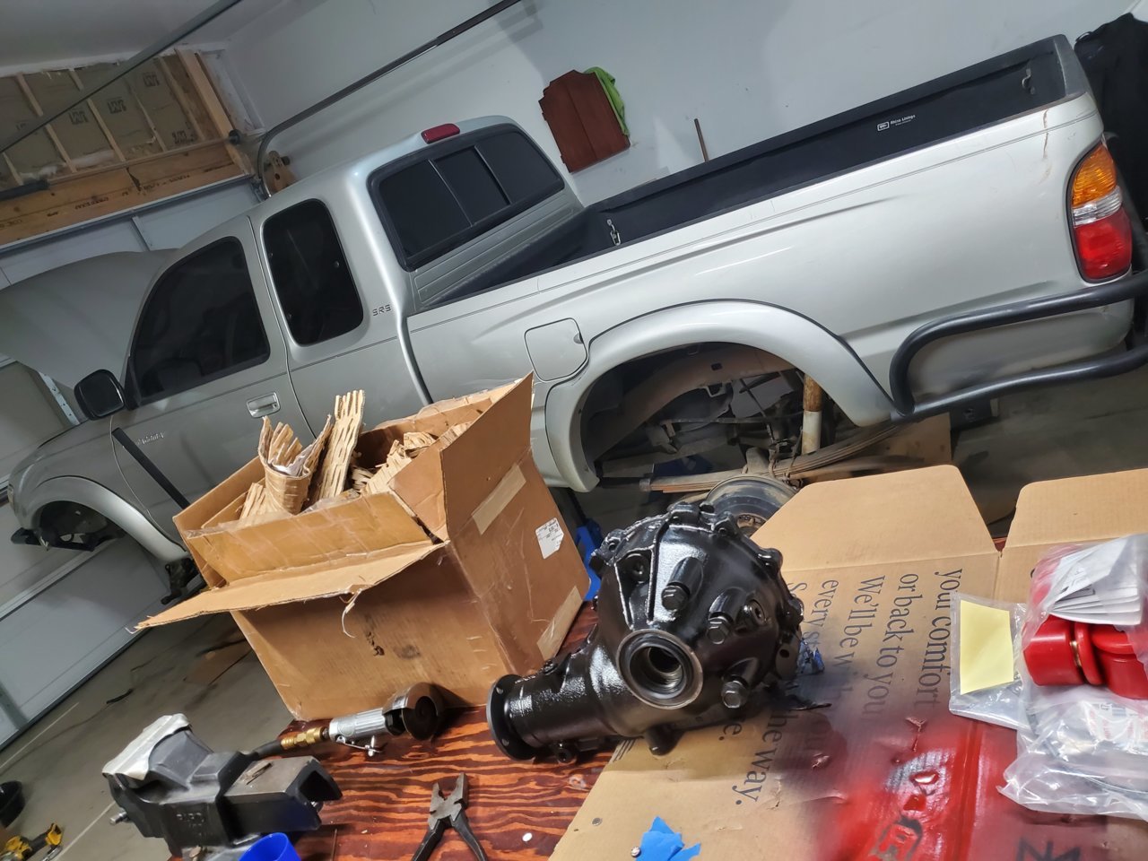

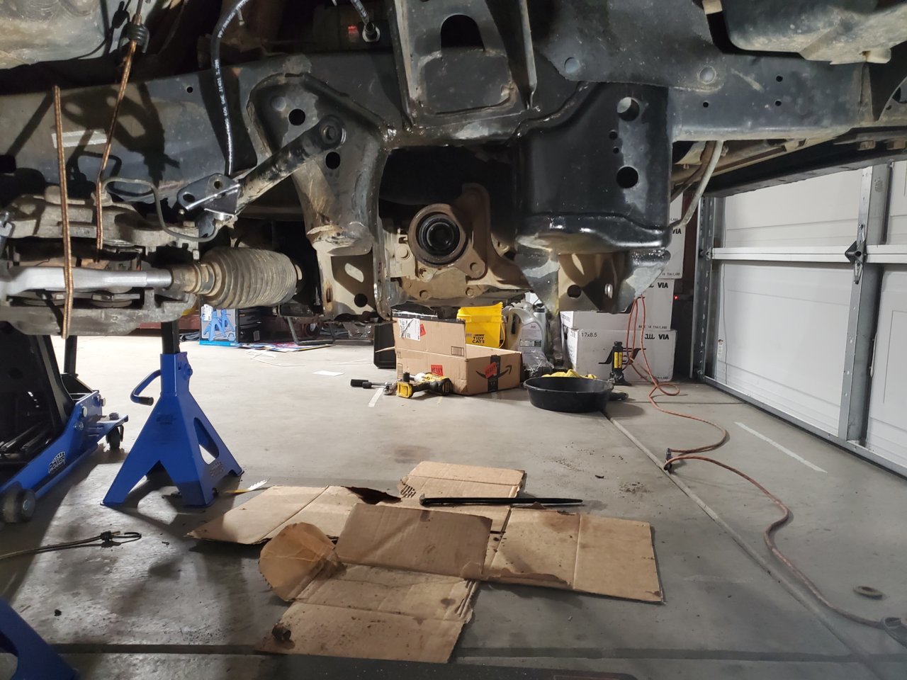

    Air compressor and front diff have arrived. Patiently waiting for my new coilovers and leafpacks to come in.
    After the last debacle with the taco I was told my LCA/R&P bushings were too trashed to be aligned. So here we are back to square one but with more bells and whistles.
    I had enough captain and coke to get as far as you see now.. and Sawzall blades to make it through one control arm. You already know what kind of fun I'm having.

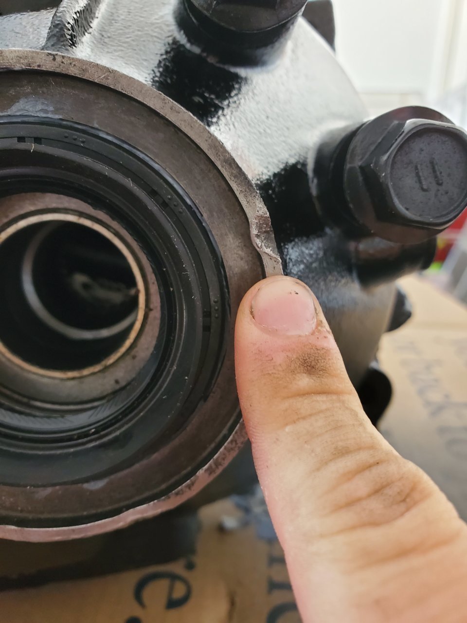

    Side notes. I painted the diff from ECGS to match the rear axle and noticed this big ol chunk missing out the driverside face. Anyone think I should be concerned about it ?

    That gouge is from the pry bar used to separate the CV from the diff during disassembly. I've created a few of them myself--those CV can be stubborn.
    I don't think you need to be concerned as long as it's not interfering with anything. That shouldn't be a contact surface. If it is interfering, I think it would be fine to just grind it back. That said, you might double-check with the more knowledgable folk in the LT thread... I've only pulled front ends apart, never re-assembled one.

    doesn't affect seal fitment, I'd run it
