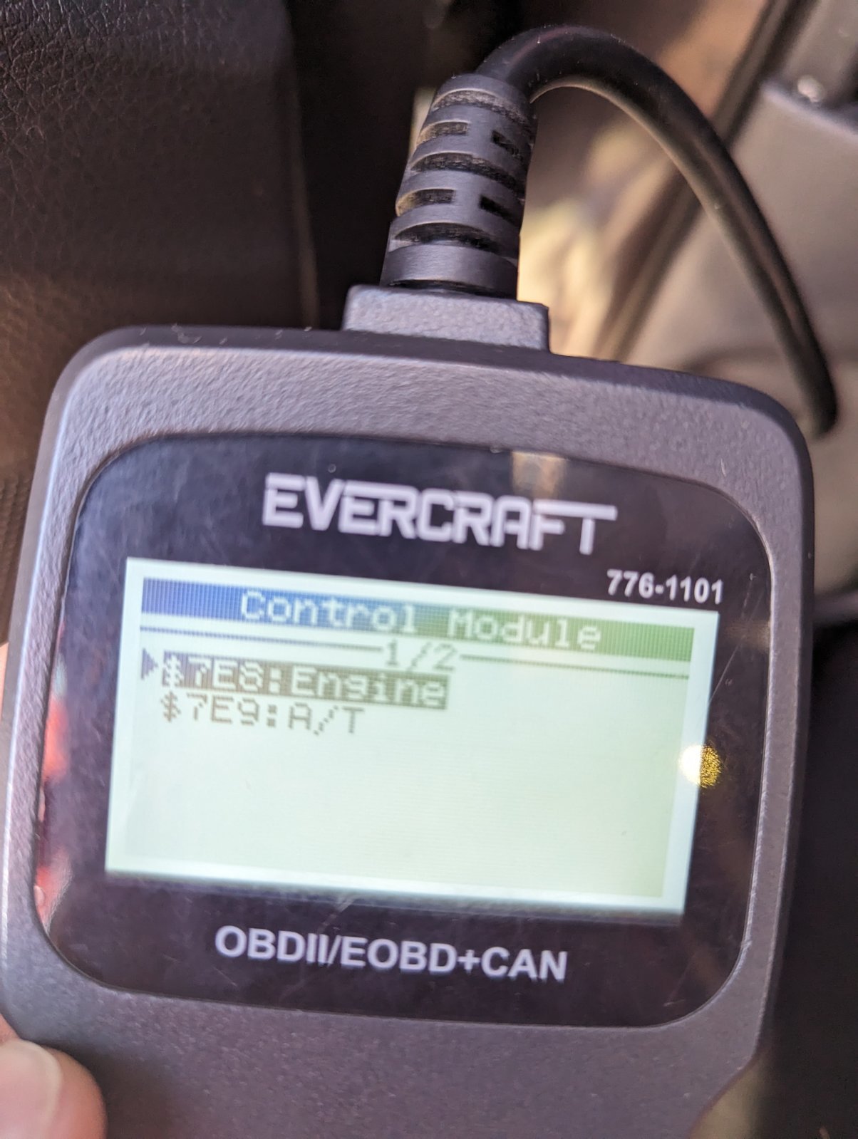

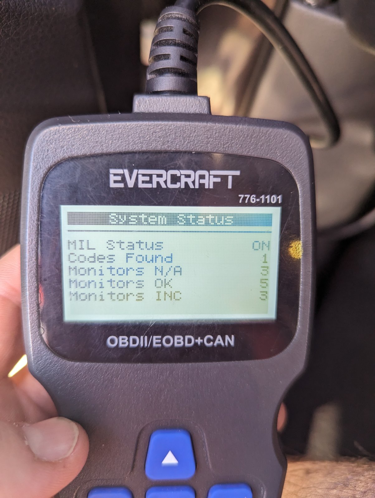

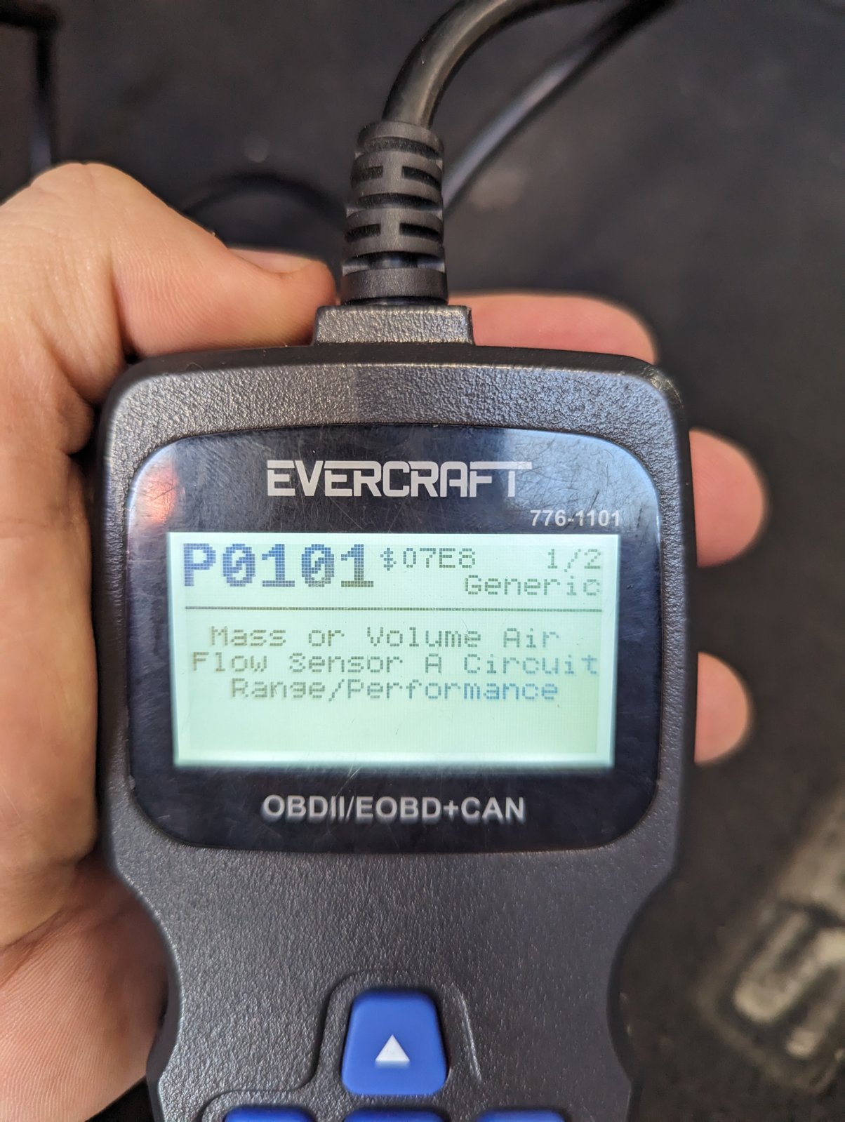

    Ugh.... Dislike/unfollow lol. No just the one scanner, might hit it again with some others to confirm
  5. Nov 22, 2023 at 9:02 PM
    JasonLee
    JasonLee Hello? I'm a truck.
    May 9, 2014
    #129454
    12,361
    Jason
    Q322+3C Denver, Colorado
    15 TRD OffRoad
    TRD Supercharger and more.
    “7E8 this is not code but a menu for the engine data stream. You will also have a 7E9 and this is for the transmission.
    Different scan tools display engine powertrain, transmission, and ABS system separately. These 3 control modules allow the scan tool to read data.
    The fault codes will be in the engine control module, but the 7E8 is letting you know there are codes. You need to select the engine control module to read those codes. The same for 7E9.
    When you retrieve the codes (if there are any), signal back if you need assistance in the code meaning.”

    Cheapest is to read for OBDII diagnostic codes like the P0172 (as an example).
    Swing on by this weekend and you can have my WiFi OBDII device that pairs to your phone. Download some free software and scan (or pay the $20ish for enhanced scanning capabilities).
    OBD Fusion is the main app I was using on my iPhone with the 1st gen when I had a scan gauge. Now I have an ultra gauge in the 2nd gen and laptop with Techstream for anything advanced.

    PXL_20231112_190219655.jpg PXL_20231112_190207327.jpg PXL_20231112_190020125.jpg

    Could be as easy as cleaning your MAF. Do not touch it with anything, clean it by spraying with CRC Mass Air Flow cleaner ($10-20 at auto parts store).
    while you are in there, look in the intake to see if dirt, oil or other contaminants are in there signaling a potential worse problem.

    I'll give that a go! Cheers! Thanks so much
