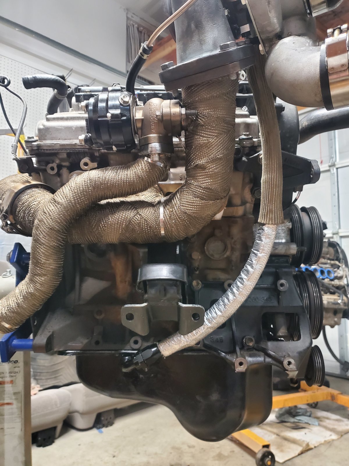

    Went a little crazy with the heat wrap. Nylon AN lines. I'll be livid if this isn't overkill enough.

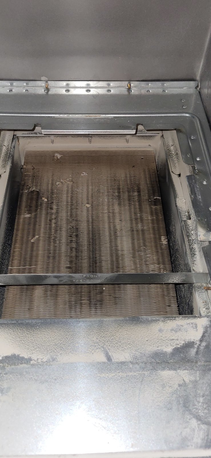

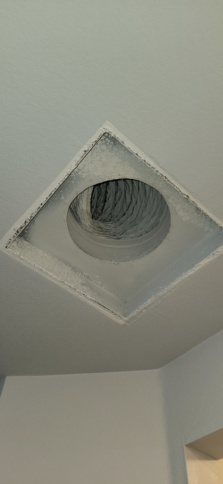

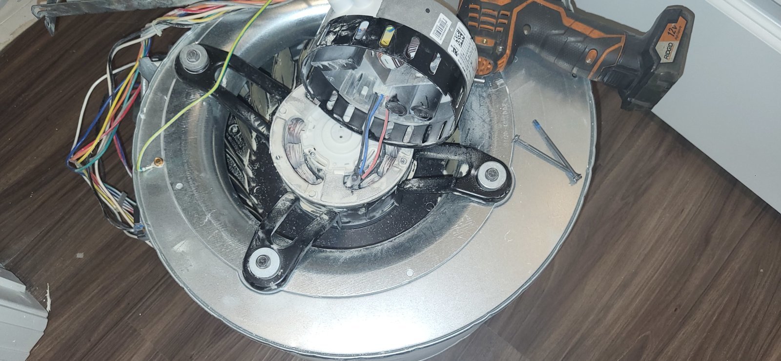

    I have a not so funny recent story about furnaces...
    @BirchyBoy
    I'm in a Century Communities home that went up recently in elizabeth, probably near where you are looking if it's spring valley ranch.
    Just had my fan motor replaced in my furnace after it started smoking on christmas morning and almost caught fire. I have only been here since May. The sheet rockers neglected to cover any vents up, and the builder neglected to re-clean them after they re-skinned and re-textured my great room because of a seam that was showing through. The result was a fan motor and heat exchanger completely caked with drywall dust, with the fan motor ultimately burning up. You can see how bad that dust is on the coils. Classic case of no fucksgivin.
    Fan:
    heat exchanger:
    Texturing inside return vents:
    The builder didn't acknowledge that it was their fault, even while standing in my living room with the HVAC company and stanley steamers looking at the return ducts and showing him how bad they fucked up, but they were quick to say we don't care who is at fault and get it fixed and didn't give me any hassle on the home warranty so I can't bitch too much about that.

    well that's some shit, glad you didn't burn your house down.

    Did they happen to scope your evap coil? It's likely caked too, which will cause the furnace to go off on high limit and the coil to freeze when using the AC. Pretty common in new home builds.

    They didn't scope it. I will see if I can get in touch with the HVAC company and speak with the tech. He seemed pretty confident that it was cleaned properly and shouldn't give any further issues
