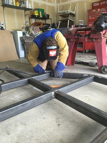

    I dont know why this isnt done yet. For the cross pieces on the bottom, did you notch the bottom sit and sit them down across that main piece going down the middle?

    5,661
    Not because of 7 day work weeks :sorry:
    So to answer your question... At least I think I know what you asking. You are referring to my frame? Yes the receiver tubing goes all the way through. This picture should explain it.

    Through it completely? like did you put holes in the cross pieces and slide them through? or did you just notch the cross pieces.

    Cut holes, slid it though all the cross pieces, then welded all the way around

    There we go. Couldn't see the other side in the picture. That's a neat idea. More strength for party activities.
