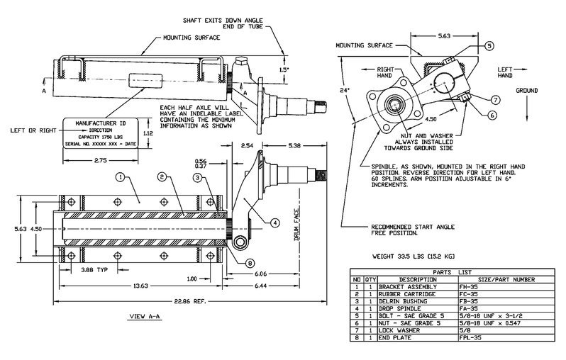

    How much room do you have from the hub (where the adapter is mounted) to the arm. I just ordered 1.25" adapters and plan to run the 20" BBS wheels. They have almost a 6" backspacing.
  17. Feb 15, 2017 at 6:30 AM
    #77
    Martyinco
    Martyinco [OP] Well-Known Member
    Aug 28, 2014
    #137132
    5,661
    Hopefully this picture can answer your question

    It did. I saw that online but couldn't make it out. Thanks
