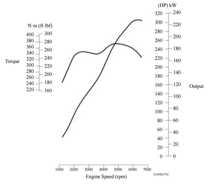

    You're not hurting it using some RPMs. The power curve for our engines isn't flat and is up sloping. Holding it at ~2,500 RPM is what I do. It's not struggling and I have power to accelerate. I'll wind it out when I do need to upshift. So that's a serious improvement from my old truck with a 22R-E, which needed to be held at 3,500 RPM or more and it would still lose ground. I'd sometime have to take that poor engine up to 5k to avoid being a bug splat on the front of a Peterbilt.

    It does look good! As mentioned above, it's okay to wind these engines up. The most HP and torque are pretty close to 4k rpms. Sometimes I forget what it was like back in CO. Here, just outside Glacier NP, I'm at 3000 feet and getting 18 mpg on 33s fully loaded with a topper to sleep under.
