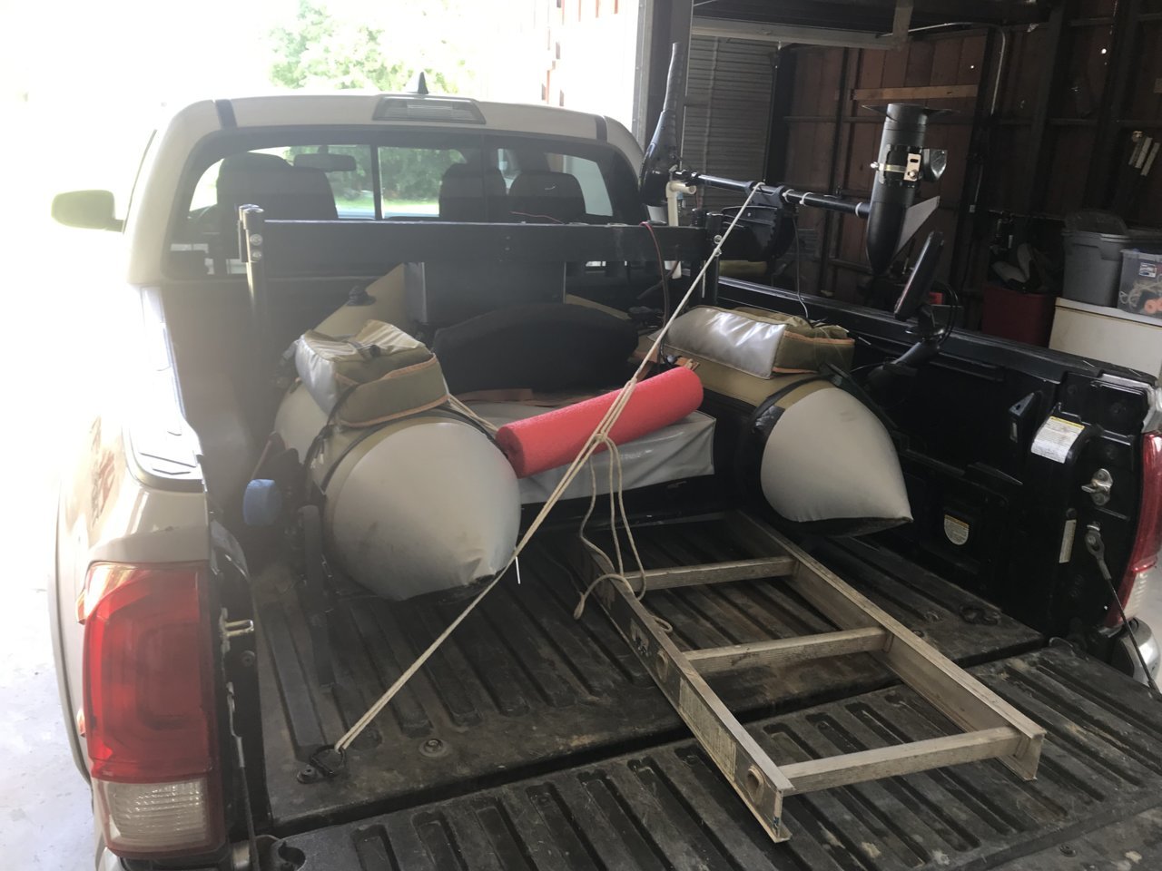

    I have the Colorado XTS with 9' pontoons. I have mounted 2, 6' 2x4's using L brackets from HD attached to the lumber bolted up to the bed rails. I got the rail inserts and bolts from Amazon with some nylon washers and bolts from Ace HW.
    I remove the pontoons and partially deflate and stuff them in the bed with everything else under netting. I use some Harbor Freight wracheting straps to secure the pontoon frame to the 2x4's. I use a double pumper hand pump to inflate at the lake. Takes about 15 mins or so to get setup.
    Way under $100 for the whole setup which is easily installed and removed. I may get a bed extender (hitch mounted) next spring that would allow me to keep the pontoons attatched, I'd still have to use the home-made bed rails. Hope this helps. I could snap a few pictures if you need some help visualizing.
