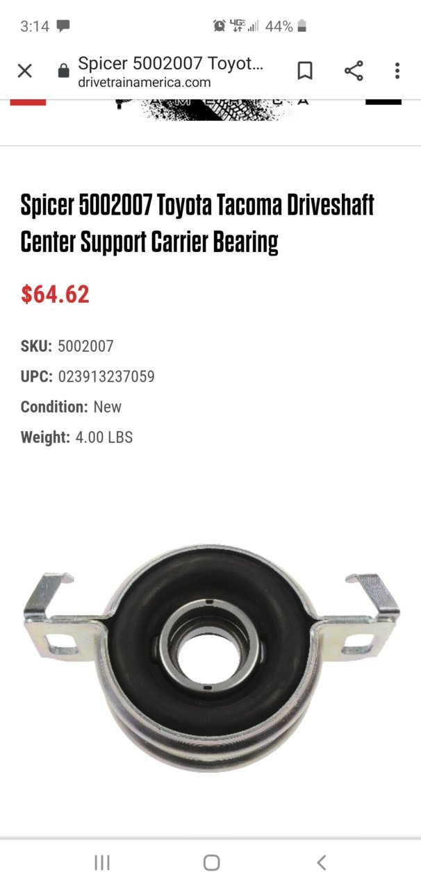

    Whelp my carrier bearing is starting to give me a slight driveline vibration. Anybody able to recommend a good replacement or better yet upgrade? I've seen some bullet ones or the polyurethane type but dont have first hand knowledge of durability/life expectancy.

    I bought mine from driveline america... only recommendation, swap all the ujoint while the driveline is off.. you will thank yourself later

    Mine were identical.. nonetheless, it doesnt matter. just sharing the info i have from when i swapped my carrier and ujoints a couple months ago. Best of luck :thumbsup:

    Well shit just checked and it looks like the spicers are made in Brazil also. I stand corrected. ;)

    Did your spicer come with 2 metal tabs?Screenshot_20200312-151434_Chrome.jpg
    Because the OEM dont or at least the ones toyota currently sells dont.

    Nope. It looked just like the oem one i removed.. let me see if i can find a part number
    Update:
    Part Info: Spicer 5002007 Toyota Tacoma Driveshaft Center Support Carrier Bearing

    That's the same part number but looks like their using either wrong image or changed the design? Fuck if I know anything anymore, just seem a good number of individuals on TW that installed Spicer had premature failures and went back to OEM @thefatkid care to weigh in?

    Probably just using a stock photo

    Spicer is the OEM builder of driveshafts for the Tacoma from 2005 onward. In this picture the carrier bearing upside down. Single hole should point down.
