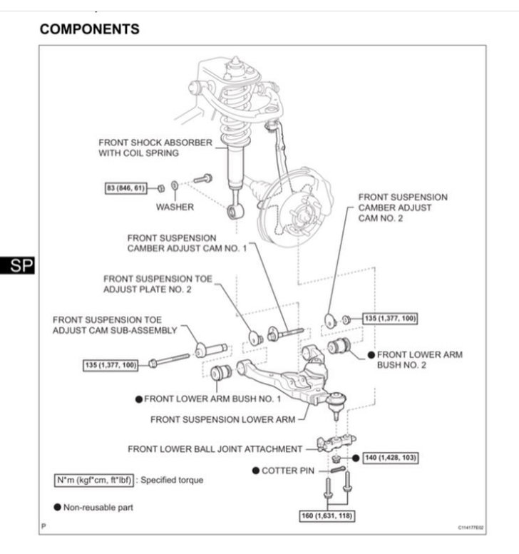

    WTB stock LCA's with free cam sleeves and <90k miles (ideally). 2nd gen but I don't think they changed them between generations. Mine are seized and the local shop wanted $300 to free them which I imagine could go downhill fast.

    its the cam through bolt “sleeve” that is seized not the LCA. You can sawzall the bolt out and buy a new one from toyota. If you do this, put a bit of antiseize on it before reinstalling. Its a simple job but can be a pita if you dont have good sawzall blades

    I just rebuilt a set and put on new hardware all mine where seized. I have my old set about 92k on them they need to be rebuilt new bushings and Ball joints needed. I swapped to white line bushings and moag BJ. I ordered new hardware online was cheaper.

    A rebuild would be a good project for me, I've done ball joints but not bushings - do you need a special press for the bushings?

    Thanks that's what I meant, just poorly worded. I can just imagine things going south so I'd rather start with a set I know isn't seized, apply the anti-seize and do the install myself instead of getting stuck without the truck because I fucked something up.

    Itll be hard to fuck it up. Even if you get new LCA, youll still have to cut out the seized cam bolt sleeve. Let me see if i can find you a diagram.
    if you are close to the springs then i am happy to help.

    I know the sleeve you're talking about, its got an eccentric hole for the camber adjustment bolt with the fixed washer.

    Yeah thats it. Just get good blades, remove wheel, slide blade between LCA bushing and LCA mounts, hold tight, then let her rip.
    afterwards, might spray the scratches with paint for good measure then install new bolts.
    i did this once in a khols parking lot because i didnt feel like driving all the way back home.

    Oh so you don't even have to take off the LCA?
    I can't tell if this is the sleeve and the bolt or just the bolt, says camber assembly: https://www.toyotapartsdeal.com/oem...assis/front_axle_arm_steering_knuckle,,48198C
