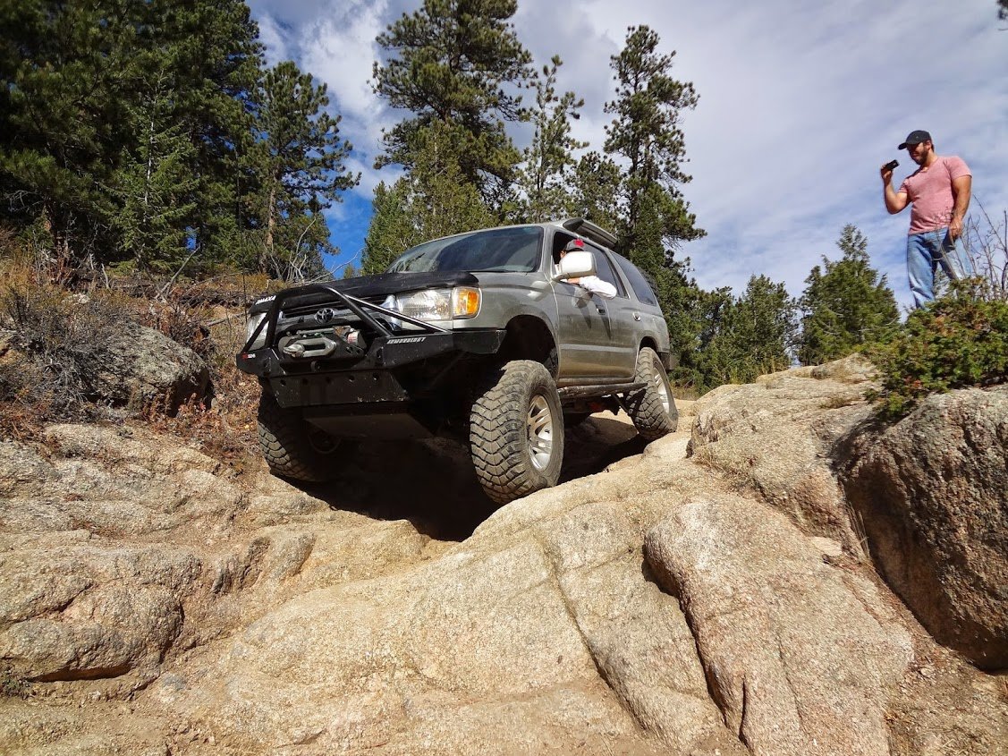

    Pretty well set up runner taking a harder line for fun

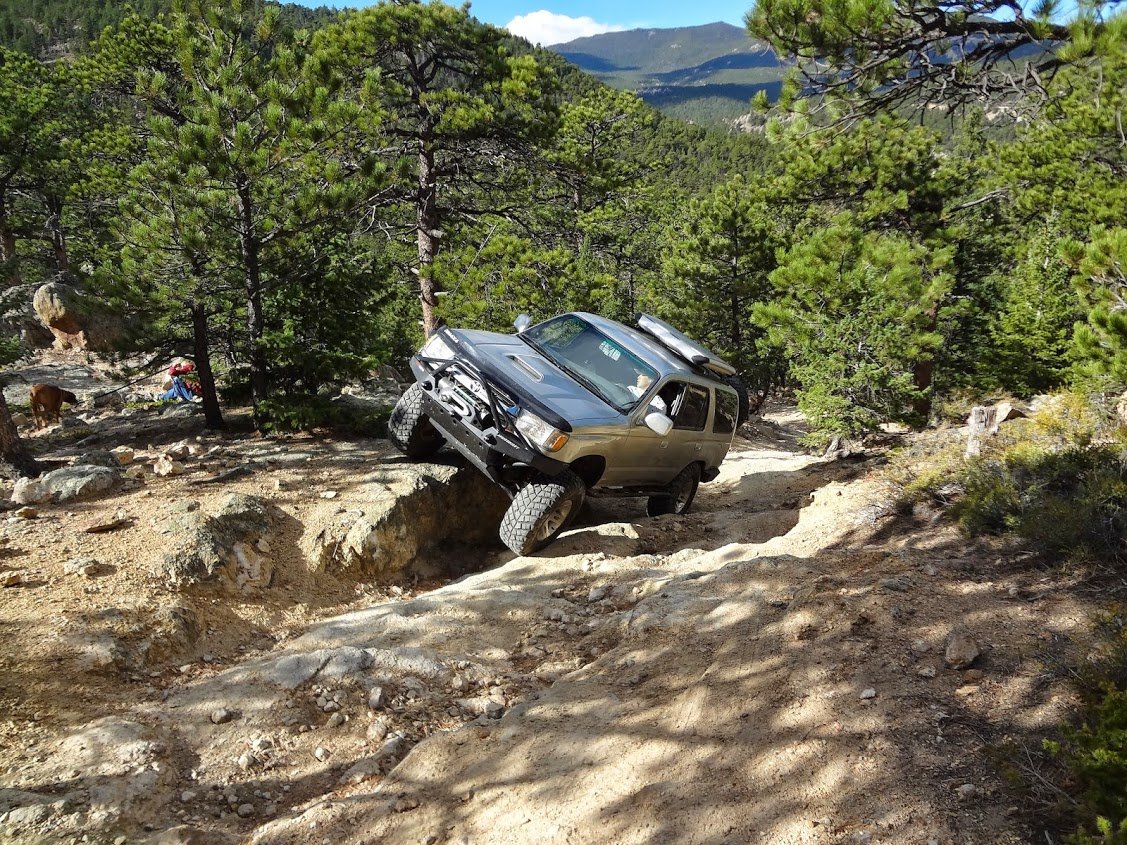

    the other runner
    and back up

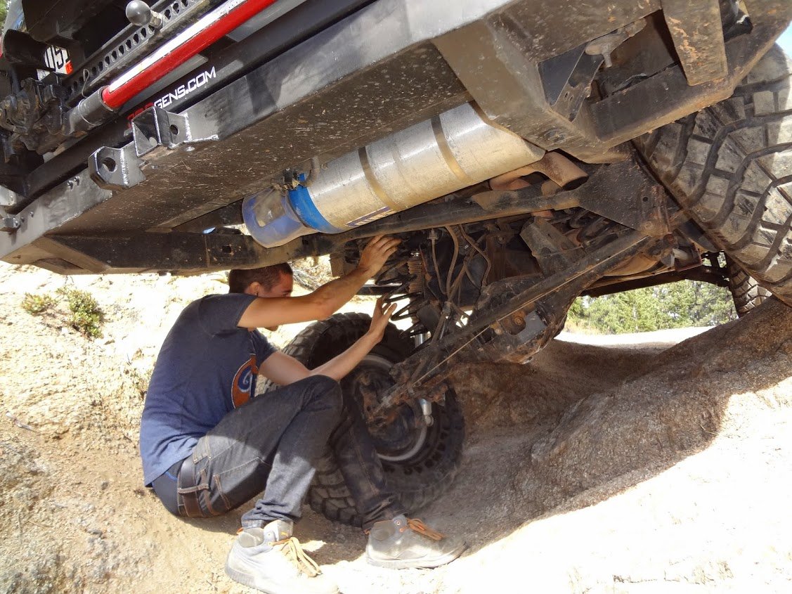

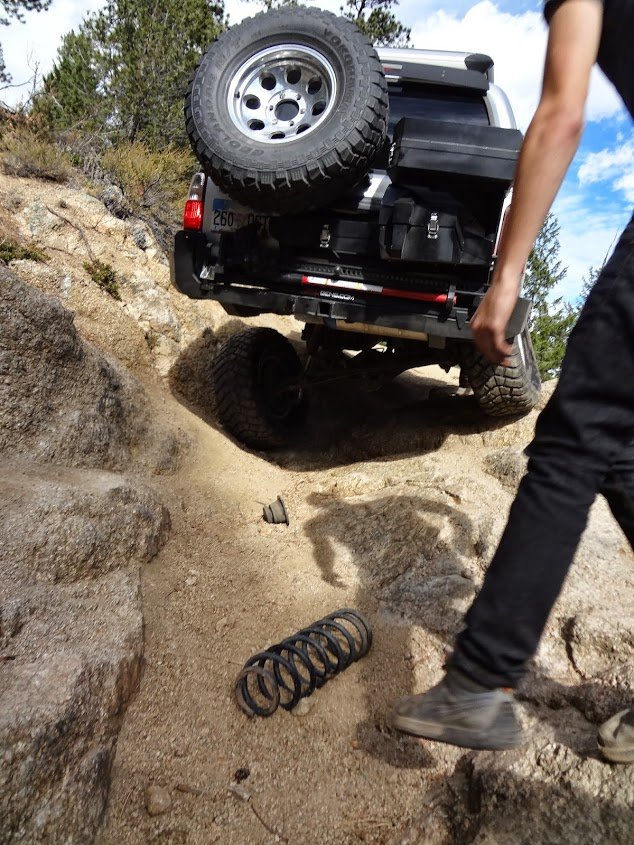

    so apparently there's nothing holding the rear coil springs in on a runner???
    turned out the guy broke both his rear shocks (sheared at the top stem) and his driver side coil fell out at max flex. we held it in with zip ties until he got over the obstacle
    poor guy had a really bouncy ride home. I thought the tacoma was bad with blown rear shocks, but this guy looked like he was part of a lowrider competition on colfax or something, bouncing all over the place.

    Damn! At least he saw it before coming back down without a spring. And yeah, without a limit they can fall out. I wheeled Red Cone with Glen and Justin this summer, he has a sweet 4R. I really like his rear bumper with the chainsaw carrier and CO2 tucked under the truck.

    But yeah, enough flex for the coil to pop out is pretty impressive, time for limit straps.

    I have seen guys make a retaining clip at the base of the springs to stop that from happening

    Well, the reason it popped was due to a broken upper shock mount, but a strap might have prevented the shock from breaking.
    Yup, mine definitely come loose at full droop, but not falling out.

    He said they were fairly new bilsteins and their condition verified it.
    The upper stud was sheared. Looks like about 3/8" (although I'm sure it's metric) threaded rod with an allen socket recessed into the end just like the 2nd gen tacomas.
    It was sheared flush with the bottom of the upper bushing. So, right where the upper rubber bushing would come in contact with the mount.

    Sounds like he unsuccessfully attempted to use his shocks as limit straps.
