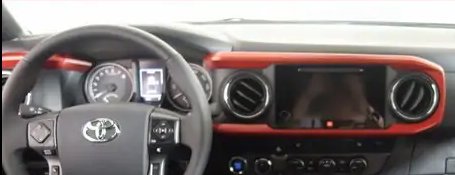

    I am not sure what they are called but I'm looking for site to purchase the colored dash bezel/trim for a 2019 TRD

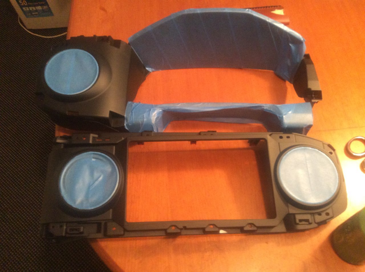

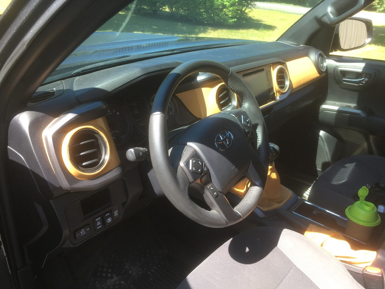

    The pieces pop of and the trim comes with philips head screws. The vents come out by releasing 3 tabs with very small screwdrivers or awls. I used testors model paint. ABS is a styrene plastic and model cars are styrene plastic. It stuck well. 1CC5F277-CB2D-44D7-8173-5FE6971F165C.jpg0787BC2B-73E5-46BA-95B5-DD2207B488DD.jpg

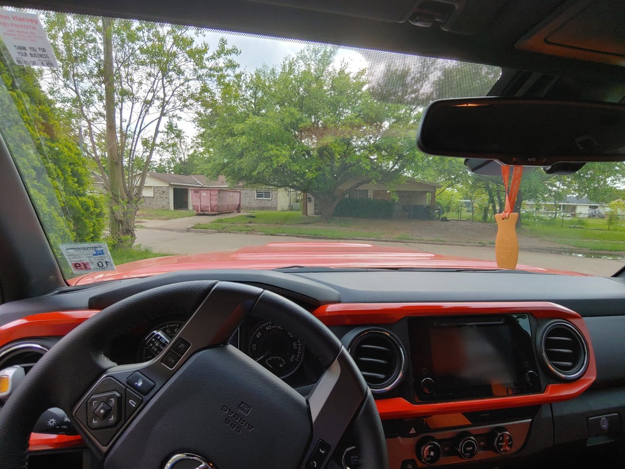

    If you are looking to change the color, just paint it.
    Mine came grey in my Inferno truck. There was someone that wanted to trade, but he was too far away.
    Finished product.
