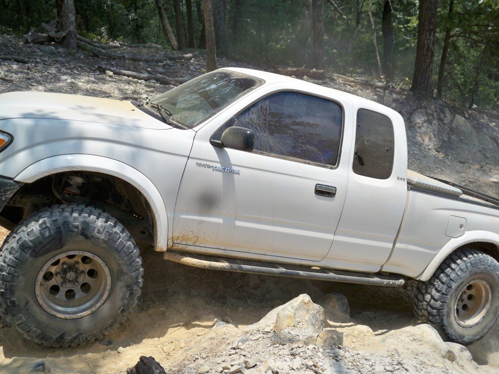

    Nice truck, I like the flares.. how did you go about doing that?

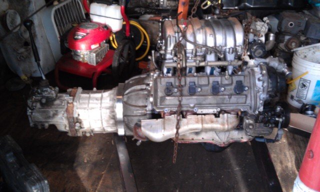

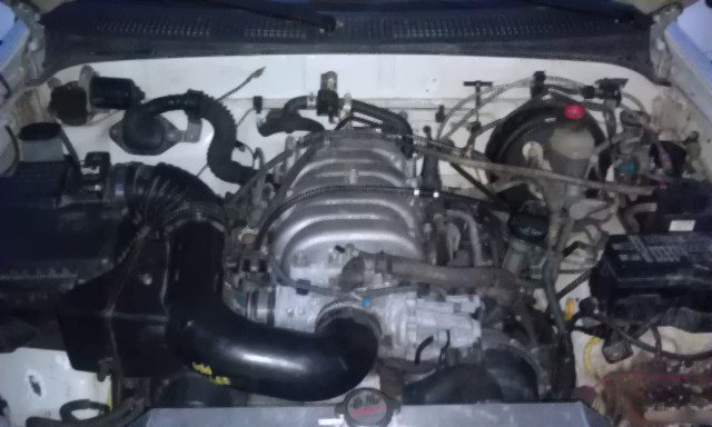

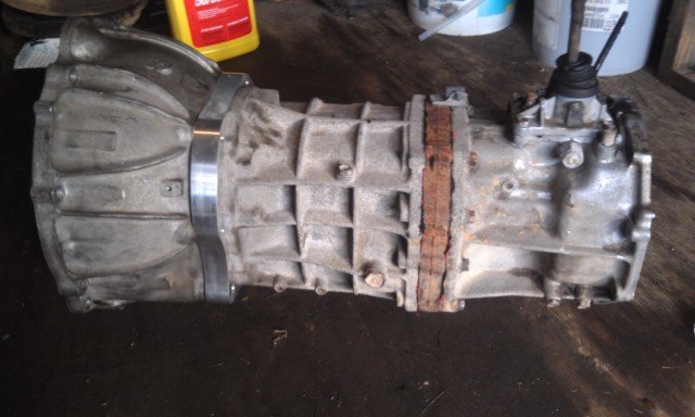

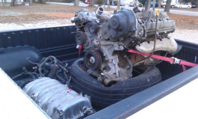

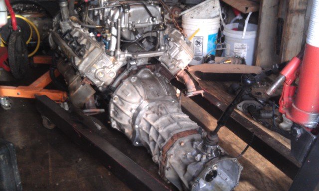

    Now what I am sure some of you want to see-
    V8 swap.
    What I started with-
    If any of you plan to swap in a v8... get a donor vehicle... Save SOOOOO much time and money... I pretty much started with a block, intake, and exhaust manifilds. everything else I have bought...

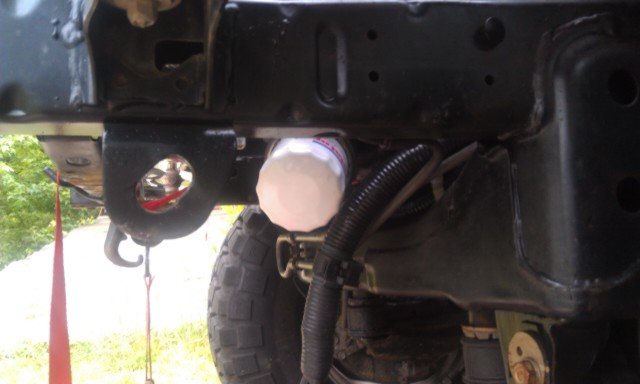

    The oil filter should be easy to get to!
    Its getting close- Im still working on the wiring.

    The flares came on my truck.

    :drool: Subbed for the v8! and thats also a really good looking truck too, i like the look of the white fender flares

    They didn't look like stock flares, I guess I could be wrong since I don't own a first gen.

    I think they are port installed, I dont have the holes in the finders. I bought the truck with 24k on it and they where on it then.
