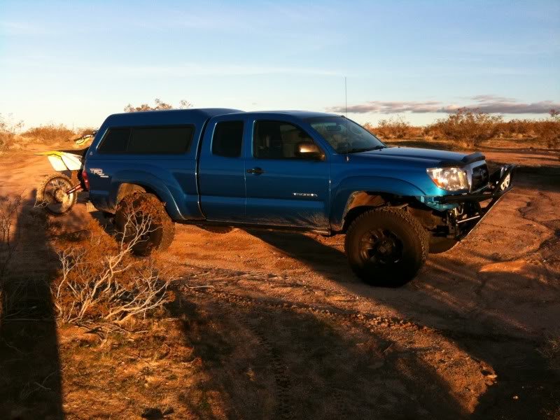

    Hey folks,
    So I put a spacer on the front of my truck and the AAL (ProComp) on the back when I went to 285/70/17s. Well, my tires rub so bad and, my sliders periodically knock on my body, so I was considering adding a 2" body lift to get more clearance and wanted to get your thoughts.
    I know body lifts are cheesy and I plan on upgrading to UCAs and Kings when I get my next gold brick, but I need to get the clearance.
    I know most body lifts are cheap nylon, but I understand someone makes a better aluminum with one bigger diameter spacers. I assume you still leave the factory rubber spacers in place when adding a lift.
    Is this acceptable? Does anyone have any examples, advice or horror stories?
    RZ Rob

    Shouldn't be rubbing that bad with that setup. What is the backspacing of your rims?

    Rubs ridiculously bad if turning over a bump at 5 mph. Back spacing is 4.5". I'm thinking body lift will stay even after proper suspension lift. I've got serious clearance issues.

    It's rubbing my flares. In fact the driver side got torn off. I was going to glass, but the forum seems to think that's not cool. I just want to know if there's anything wrong with going for a 2" lift?
