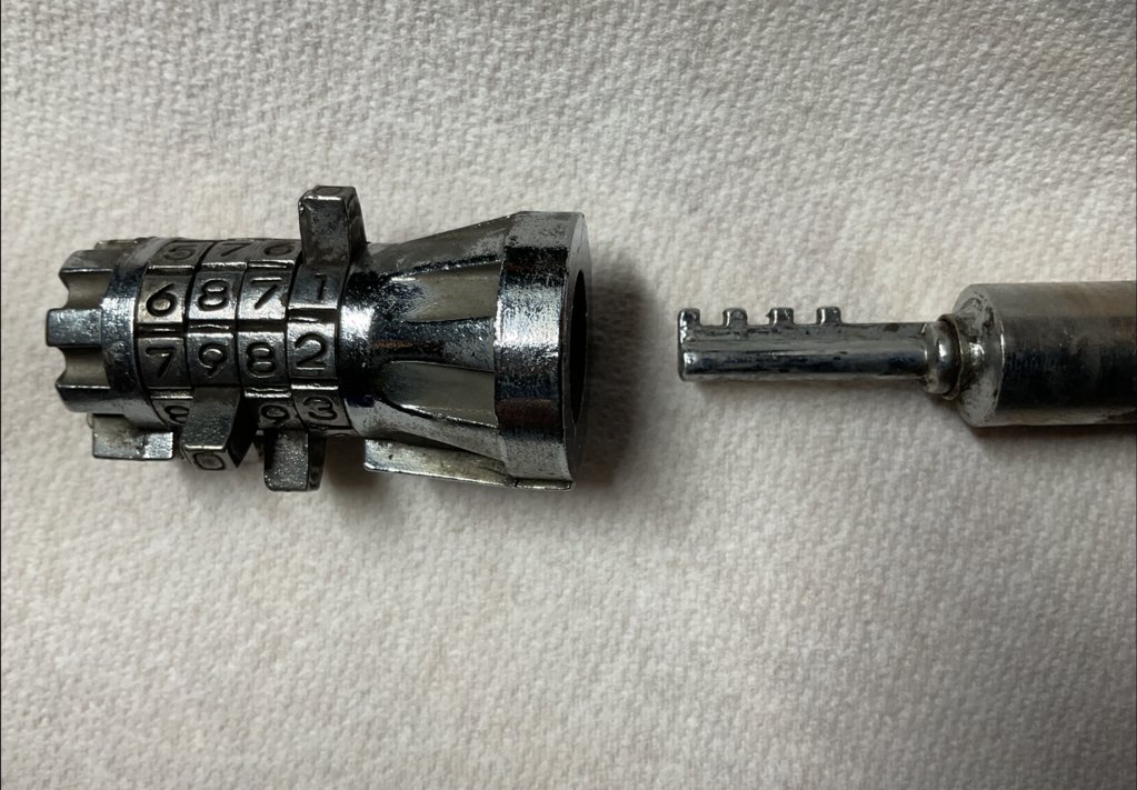

    Can you just buy a longer 4" x 5/8" pin for the lock head to attach to? You need at least 3-3/4" of clear pin to make it between the outside edges of the receiver block.

    Maybe, depending on whether the locking mechanism being compatable with the pin.

    That Trimax locking pin has teeth on the end, unlike other locking pins. So no, that won't work.IMG_0369.png
