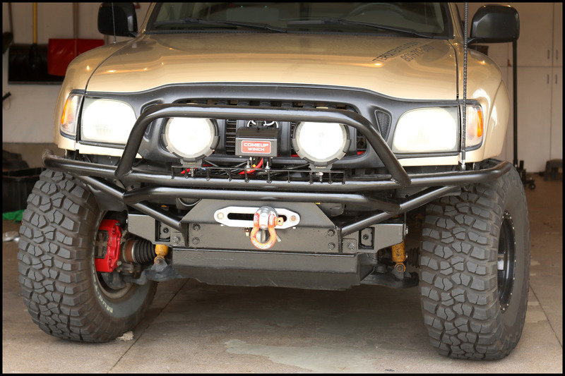

    I attached mine to a flat surface on the center of my bumper. I'm sure you could do that on the top of your plate bumper too if it didn't fit inside.
