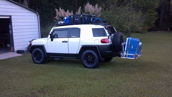

    Sorry I can't help with your questions either but I also miss my FJ sometimes. They are pretty unique vehicles.
    But, I still love my Taco and I am driving it a lot more!
    My old FJ, right before a camping trip a few years ago...

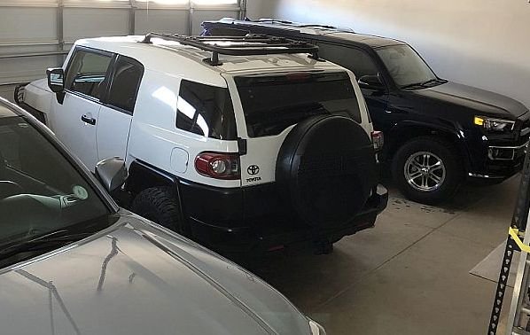

    Good Looking FJ:thumbsup: Here is mine sitting in the garage and no place to go camping.
