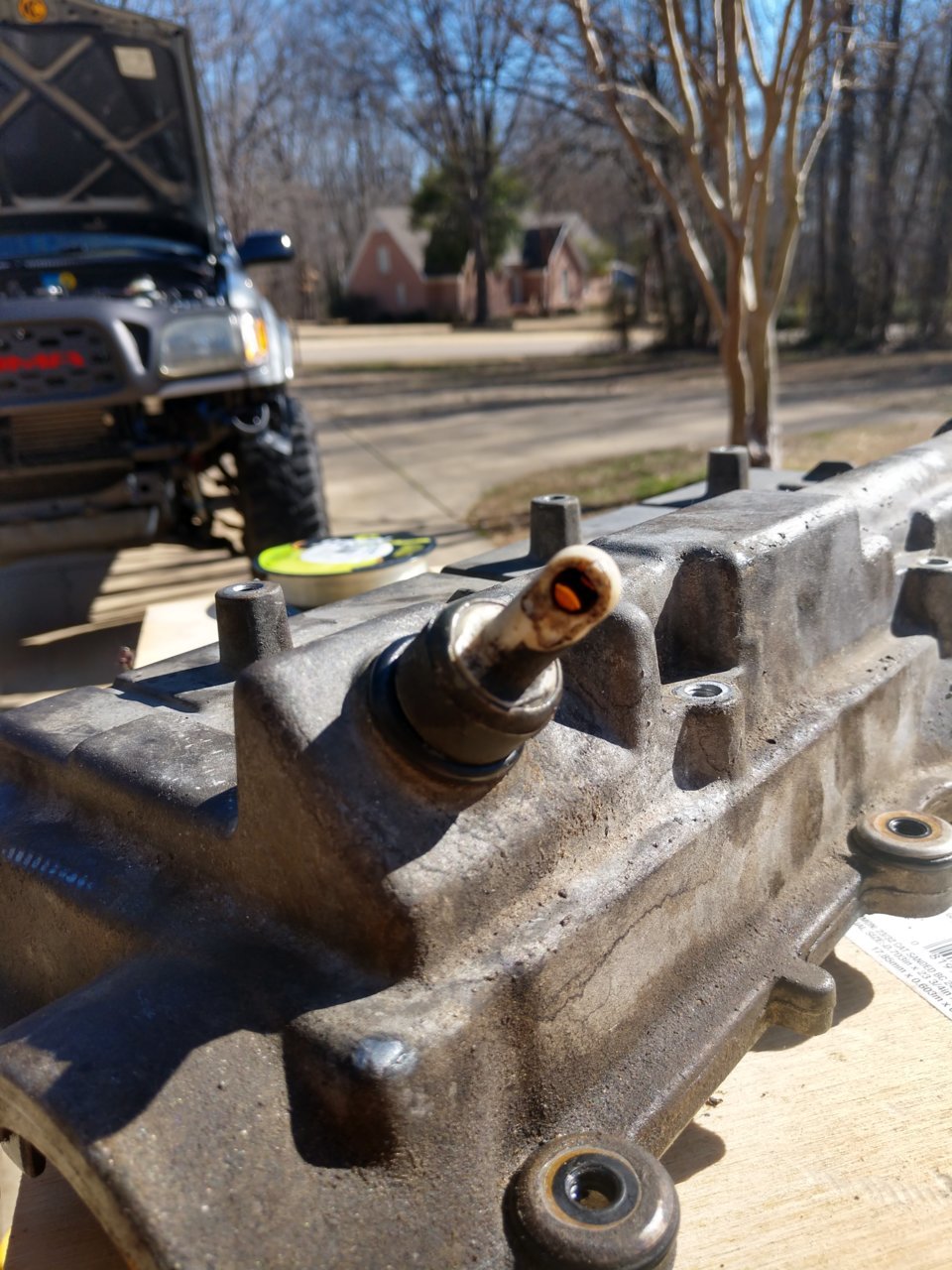

    Doing the valve cover gaskets today... I messed up of course and don't know what to do. I bent a piece inside the pax side and don't know of it's important or not and I also broke the damn elbow coming out the top.
    How do I replace the elbow?
    How do you get this out?
    I bent that rectangle piece trying to get the effing sparkplug tube gaskets out. I've bent it back mostly straight...is that an issue? I knew I should've just paid somebody to do this crap!

    That elbow is just your PCV valve. If you're doing the valve covers etc (which it appears you are) you should replace the PCV valve and grommet anyway.
    The old PCV valve is a bit of a bitch to get out because it's brittle and the grommet is probably hardened. I broke my PCV valve like you did, trying to get it out.

    Okay how on the world does this thing come out?

    From the top, I used needle nose pliers. Since yours is brittle it will probably just break away in pieces. Good thing the valve cover is off while you're doing this.

    Okay so I just pull on it? No twisting or anything?

    Yeah just pull on it. Twisting may help.

    Got it!!!! If you guys are ever in West TN I will buy you a beer.

    that piece you bent not a big deal as long as the air can flow its good, Just give the entire inside and outside of the valve cover a good cleaning (Don't be like a neighbor did and use gas to clean) we can still see the black burn spot in his driveway....
    the broken plastic elbow is just part of the PVC valve and you want to replace that anyways they come out hard after years of heat hardens the grommet I just take a pair of pliers and turn it back and forth while pulling up gently at the same time it will come out just don't pry it out and damage the aluminum valve cover because then you will really want something stronger than a Beer.
