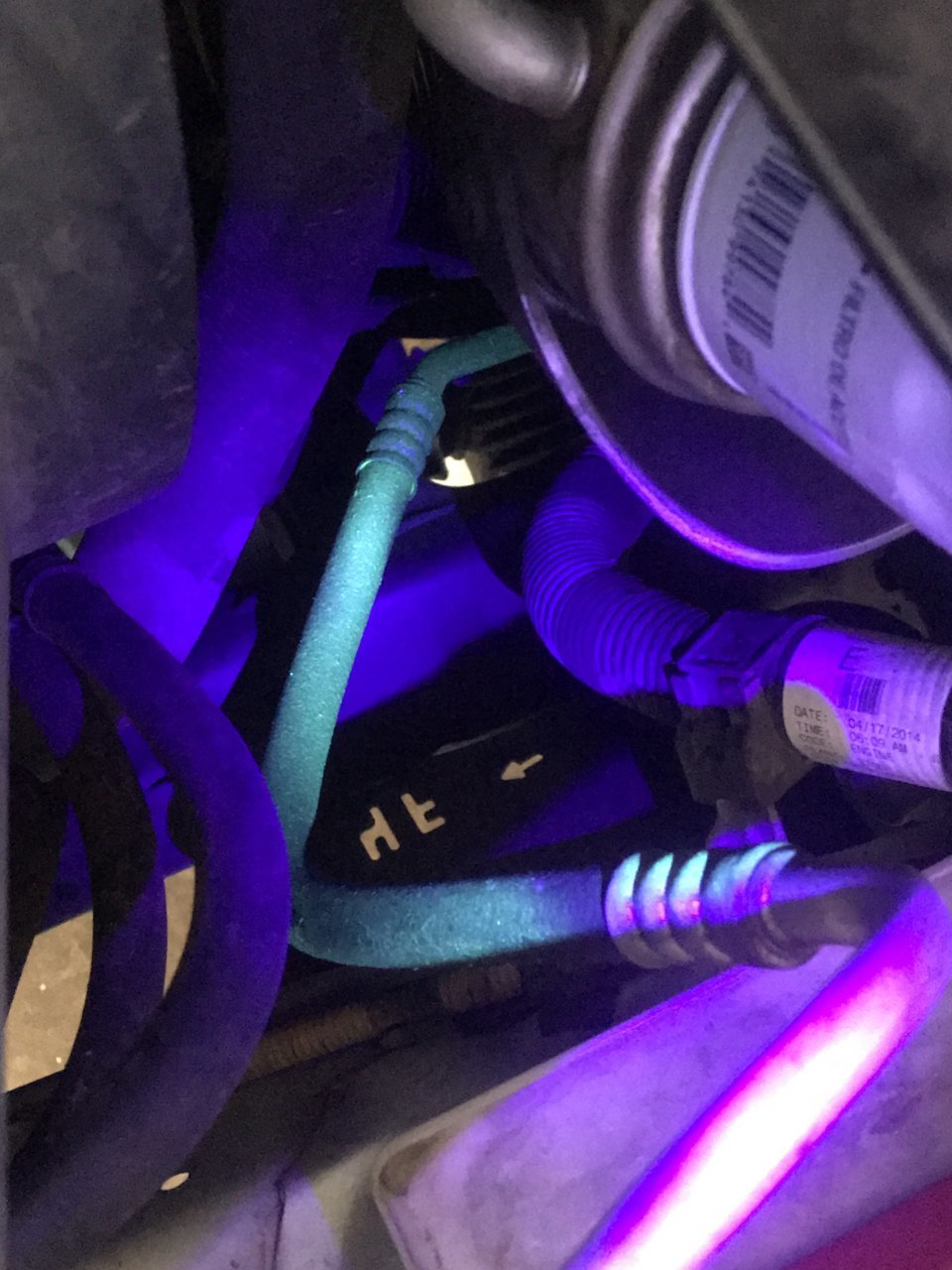

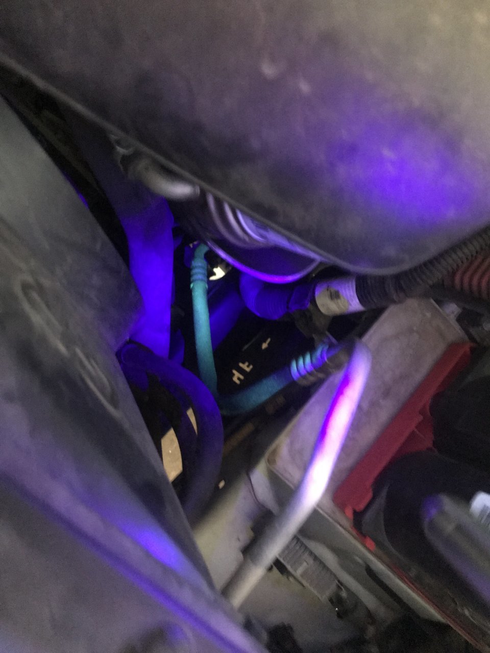

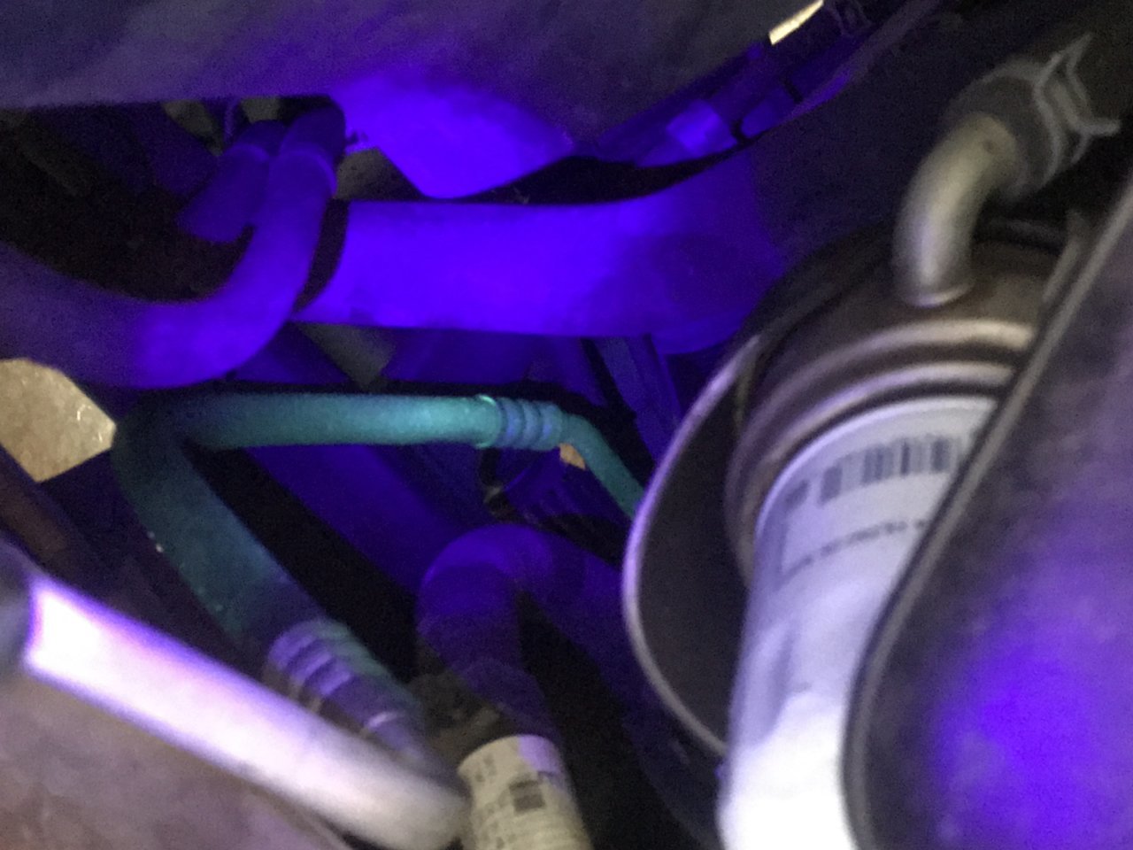

    So I have the same issue - dye test shows the compressor area (more of the ac hose rubber and metal ) — it’s freaking everywhere !! I’m guessing the leak happens and it gets on the belt and flings it but ..... it’s only on the ac hoses and not on ANYTHING else. Strange ...
    This is strange because I just did my first top off 1.5 months ago and now today I started to investigate as it was warm again (only on passenger side). For as much dye as I find - I would assume I would have to be filling Freon on the weekly ... has anyone changed the rubber and metal hose that goes from the Compressor to the first valve near the headlight / radiator? Parts show to be about $25.

    Looks like high pressure got your hose. Make sure the condenser and radiator are clean, and the fan clutch is working properly.

    Thanks curt ! It all seems to be in good working condition. I cleaned as much of the hose as I could to check the next few days and see if I can tell where it is coming from. I may just replace the whole hose

    For what its worth, the dealer had trouble finding my leak as well. Took it to my mechanic and they found the leak right away. Apparently the discharge hose is a common failure point.
