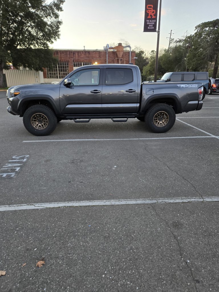

    Can confirm, rubbed out quite a few- uh, rubbed slightly against the back of the wheel we'll after installing OME ucas but a good alignment fixed it.20250117_172129.jpg
