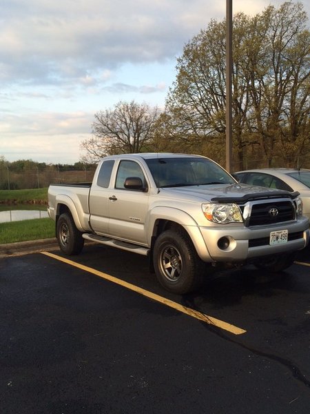

    I just put on 265/75/16 Cooper AT3's with Level 8 MK6 wheels. Delivered to my door by discounttiredirect.com. Very very slight rubbing on the mud flap and only on the passenger side. No change in MPG per odometer calculation.
    This tire/wheel combo is actually lighter than the stock steelies and 245's and since the tire is larger, you get 4% more distance per rev and slight increase in actual MPG.
