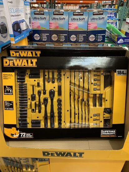

    Saw this at Costco for $99. Not sure if they still have it. I wonder if there’s anything similar and possibly cheaper also in a convenient plastic storage case.
    I found myself needing sockets wrenches and ratchets today, and had none. 3/8 and 1/4 would have worked, with short and deep sockets.
    curious to know who has something like that
    Some off the stuff in the DeWalt set seem useless. Like nut drivers that go onto an electric tool to remove Mercedes bellypans.
    Obviously DeWalt is (was) known for power tools. Not hand tools. So I’m sure they won’t grip as well as million dollar snap on.
    But for occasional emergency use lower quality would suffice.

    So the big DeWalt set at Costco is now gone but they have this for $30
    aside from the most basic of tools isn’t the point of Toyota that it’s reliable enough to never break or only break in a way that is still stable enough to wait until you get home to fix it

    That might work if you break down at the mall, but if you are 3 hours from pavement, let alone any kind of civilization, a few more tools in the bag might be in order. If your clever with sticks and rocks, no tools are even necessary.

    I bought this one. It is kinda crappy. That being said it works good for leaving in the truck all the time.

    Black tools might be the single worst invention, ever. I bet you'd be lucky if you used 1/5th of those tools. However that was my first approach (not that kit, but a general socket type kit with a few other hand tools). Then space started to become a concern and I wanted to tailor it to this specific vehicle, and to things that might be corrected on the trail (I've got tons of tools at home, and I'm not going to be getting deep into the truck when I'm out and about).
