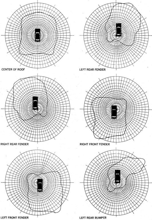

    Good questions and answers here. Ham VHF is the gold standard but GMRS license is $70 for 10 years with no testing. One reason VHF is better through trees is pine needles absorb GMRS-band energy since they are about the length of a quarter-wave antenna.
    Either way, for offroad comms GMRS is awesome, CB is a little less awesome (but curious to test forthcoming CBs in FM!).
    If you don’t want to nerd out with we RF guys, just get a Midland MXT275 (15Watts) or the forthcoming MXT575 (50Watts). I haven’t yet tested the 575 but the 275 is awesome if you upgrade the antenna to a Laird, Larsen, or Comet tuned to 465MHz. The important thing is to get the antenna outside the vehicle.

    Nice summary.
    To your antenna comment...totally agree on importance of location on exterior.
